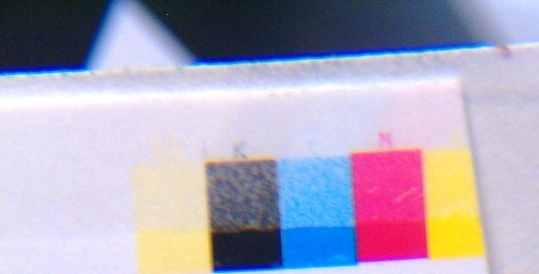

If you have a loop you might be able to see it on the surface depending on the type of coating used. I use a loop to check my coating lay down from time to time.
