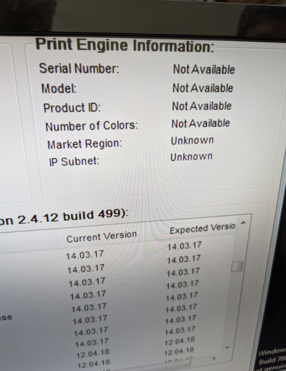

SYSTEM REPORT MISSING ALL PRINT ENGINE INFO
The system report program shows not available for serial number. I did notice that the PCUI is missing Visual Studio C++ and the current version of MS Access is 14.0 and expected is 12.0. Not sure if that could be related.

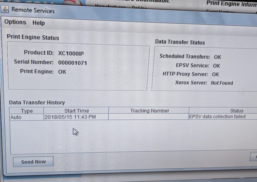

REMOTE SERVICES SHOWS SERIAL NUMBER OK
On the remote services Application, it is able to read the serial number no problem., in the transfer history it shows EPSV data collection failed. Try to click the send now button it goes through and gathers all the information off of the press like but after it finishes going through all the different steps, ends with the same error saying EPSV data collection failed. Also not sure if related.

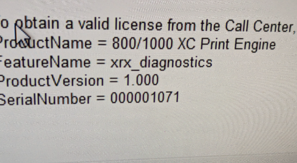

DIAGNOSTICS LICENSE SHOWS CORRECT SERIAL #
Within The diagnostics program, I'm able to view the license details and it does show the correct serial number which also matches the serial number shown on remote services which is also the actual serial number of the press. But for some reason diagnostics says it doesn't match and I'm assuming it's because diagnostics isn't receiving the actual serial number.
