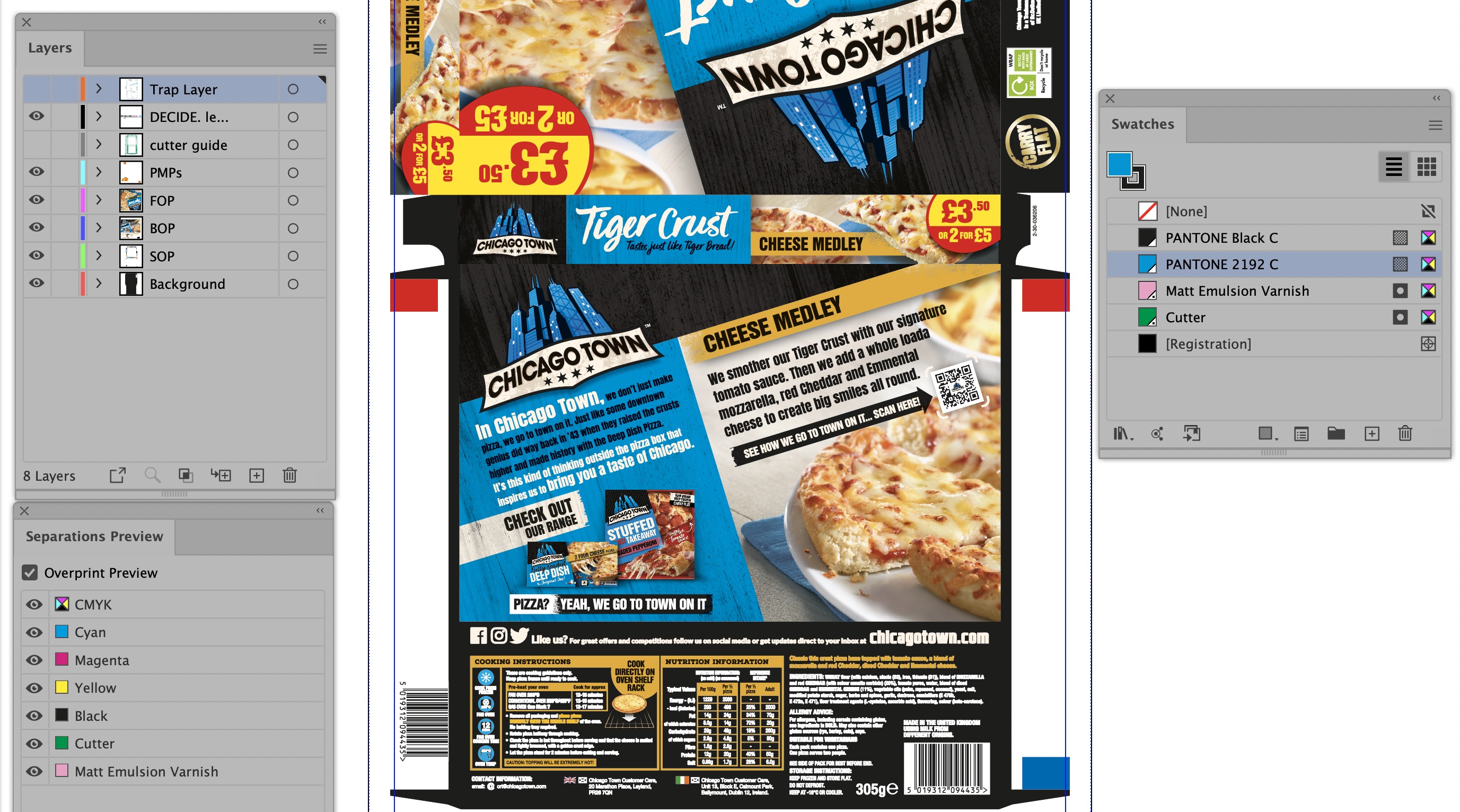

Hi david,
I downloaded the PDF file and checked it.
I did not see a problem, everything is correct.
You can watch it in the attached video.
