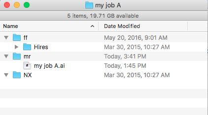

Does anyone know how to make a simple app or workflow with the Apple Automator? Here is what I need to do: Drag a file on a workflow that will create a folder by the same name as the file and then place that file in that folder, inside another folder named “mr”. As well as creating some other folders named ff/Hires and “NX” in the same folder. Example attached.

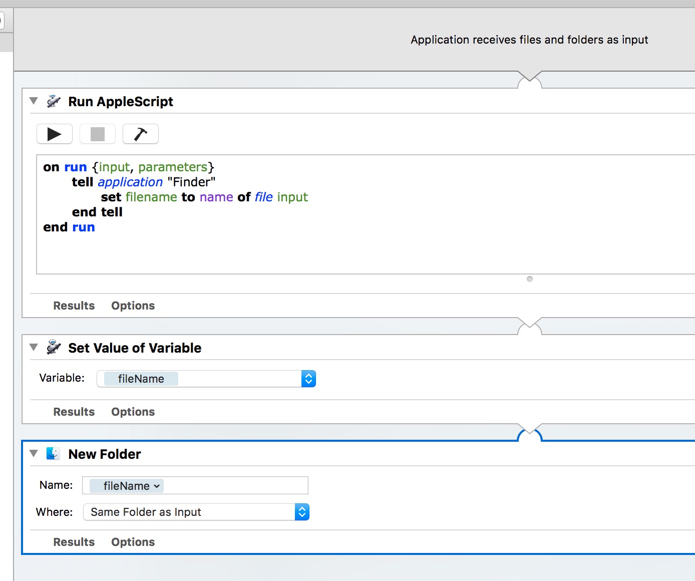

I am not the one to provide a workable answer, however I am sure that others can! I am probably going wrong somewhere with the following, either in the AppleScript or in the automator components. Anyway I fell over at the first step…
Good luck!

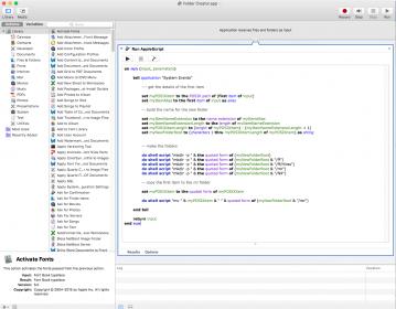

Hello,
I've managed to sort this using Applescript.
In Automator create a new Application (where Application receives files and folders as input).
Then add an AppleScript Action.
Then copy and paste this script....
on run {input, parameters}
tell application "System Events"
--- get the details of the first item
set myPOSIXitem to the POSIX path of (first item of input)
set myItemAlias to the first item of input as alias
-- build the name for the new folder
set myItemNameExtension to the name extension of myItemAlias
set myItemNameExtensionLength to the length of myItemNameExtension
set myPOSIXitemLength to (length of myPOSIXitem) - (myItemNameExtensionLength + 1)
set myNewFolderRoot to (characters 1 thru myPOSIXitemLength of myPOSIXitem) as string
-- make the folders
do shell script "mkdir -p " & the quoted form of (myNewFolderRoot)
do shell script "mkdir -p " & the quoted form of (myNewFolderRoot & "/ff")
do shell script "mkdir -p " & the quoted form of (myNewFolderRoot & "/ff/Hires")
do shell script "mkdir -p " & the quoted form of (myNewFolderRoot & "/mr")
do shell script "mkdir -p " & the quoted form of (myNewFolderRoot & "/NX")
-- copy the first item to the mr folder
set myPOSIXitem to the quoted form of myPOSIXitem
do shell script "mv " & myPOSIXitem & " " & quoted form of (myNewFolderRoot & "/mr")
end tell
return input
end run
It will only work on one file dropped at a time (the others are ignored)
It won't work correctly if Folders are dropped on it.
Good Luck
