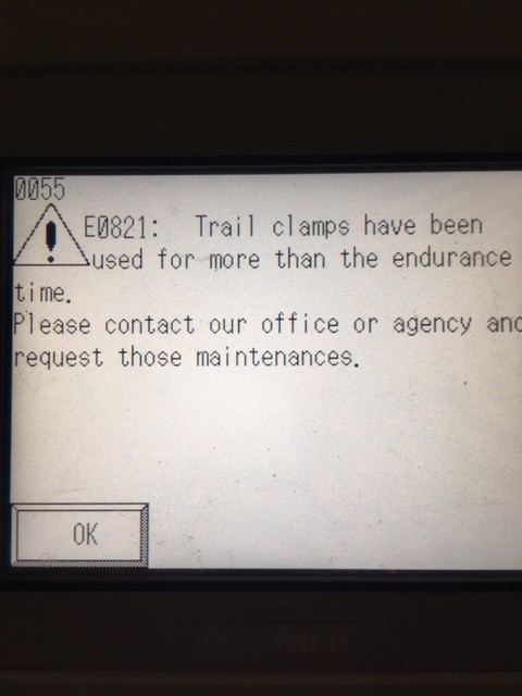

Hi all we have the Avalon-N4 and we need to replace Trail clamps. We have the new parts to put in but the tech will not be able to get here for a couple days. Is there a way to get around this?On the control panel.
thanks for the help

Michael, it is just information, that there is a time to replace TC. You can ignore that and expose plates. It is consumable, factory want earn money.
A lot of my customers made 30000, 40000 windings on the same set of clamps easily. There is also a repair kit, no need to replace whole clamps.
Do not get fooled by greedy companies.
