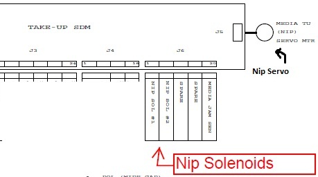

Please open the attached file for the connector position of the NIP solenoids and the Motor on Take up SDM. Make sure the wires are connected to the connectors properly. Check the wires for continuity with a Multi-meter. Align(adjust) the Solenoids to make sure they actually move back and forth with the aid of AVdiag and unidiag commands. Further, try to test the motor for proper functionality and replace it.

Did you check the connectors to be connected to right spots on the take up SDM according to attached diagram?
