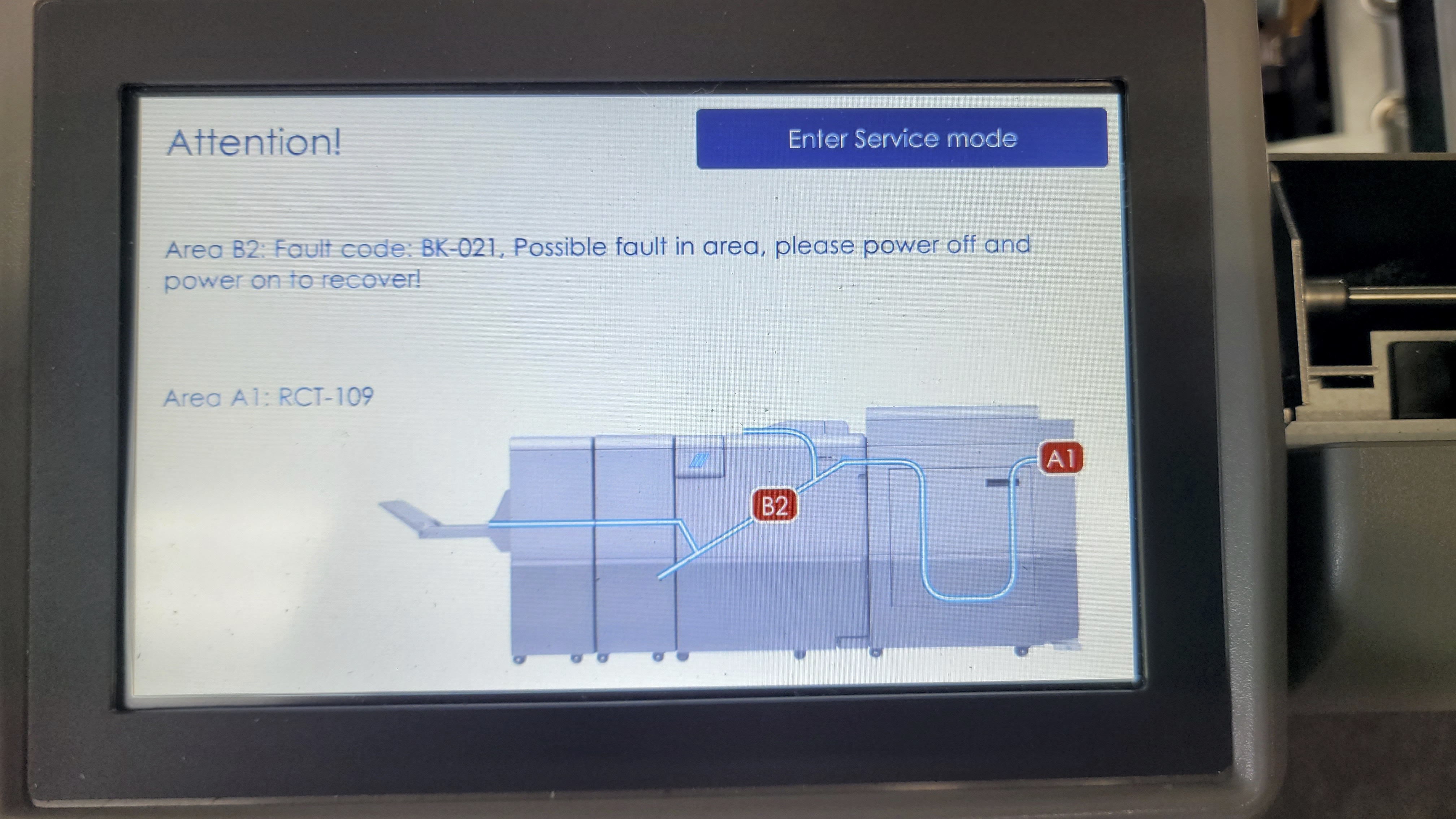

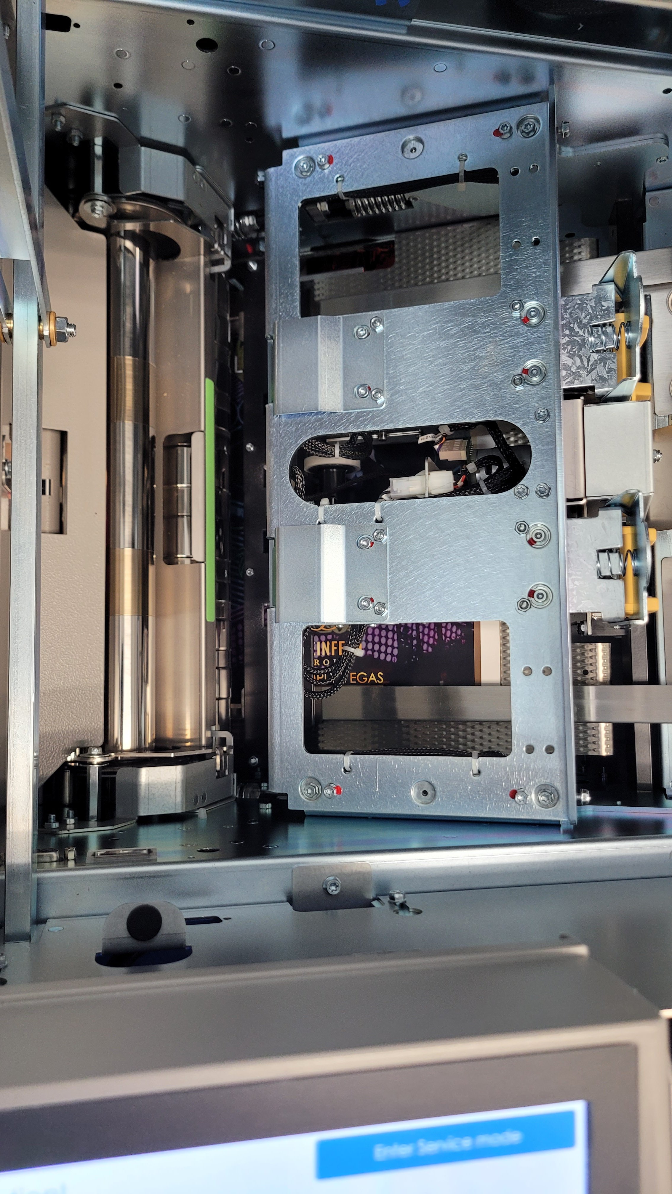

Wondering if anybody has encountered this error code, specifically the Are B2: Fault code: BK-021 error. We've been dealing with this issue for a couple months now, and our repair tech came out to take a look. After running diagnostics, he concluded it was a piece that belonged to the motor, so he replaced it. The issue persists.
Attached are images of the error code along with an image of where the paper gets stuck (just after the staple module). We've had a lot of paper wasted due to this error, so I would love to hear anybody's thoughts on this.

Our Ricoh tech came in about a week ago to change out a motor in the area the booklets get stuck in. It fixed it the rest of that day, but it went right back to getting stuck the next day.
I do remember him saying something about how the error codes as well as the manual are very vague. I guess I'm just going to have to have him try something else next time he comes in.
