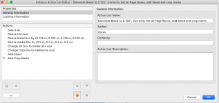

I made you new action that forces trim box and resizes other boxes, than add bleed and crop marks, it works on my end.

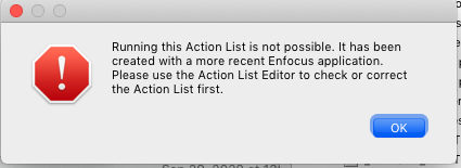

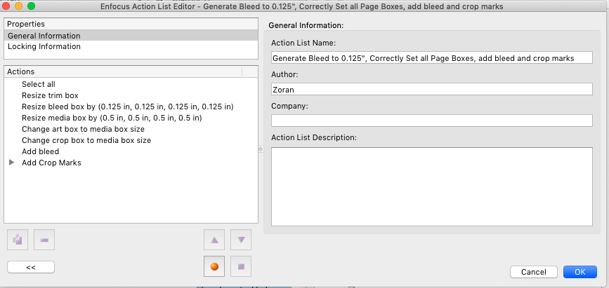

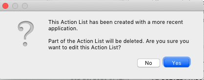

Zoran:
Thank you! Unfortunately we don't have latest PitStop, (still on 13) and when we try your action we get error. (see attachments).
After opening (and I guess removing the incompatible portions) we get the same result as prior.
