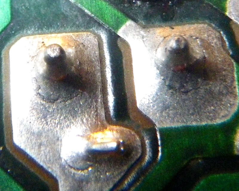

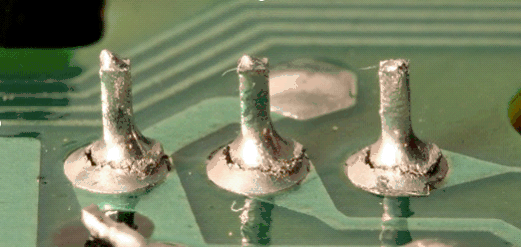

4) By other side please resolder the keyboard board for : Dry +Cold solder Joints ( attached is there the examples)
