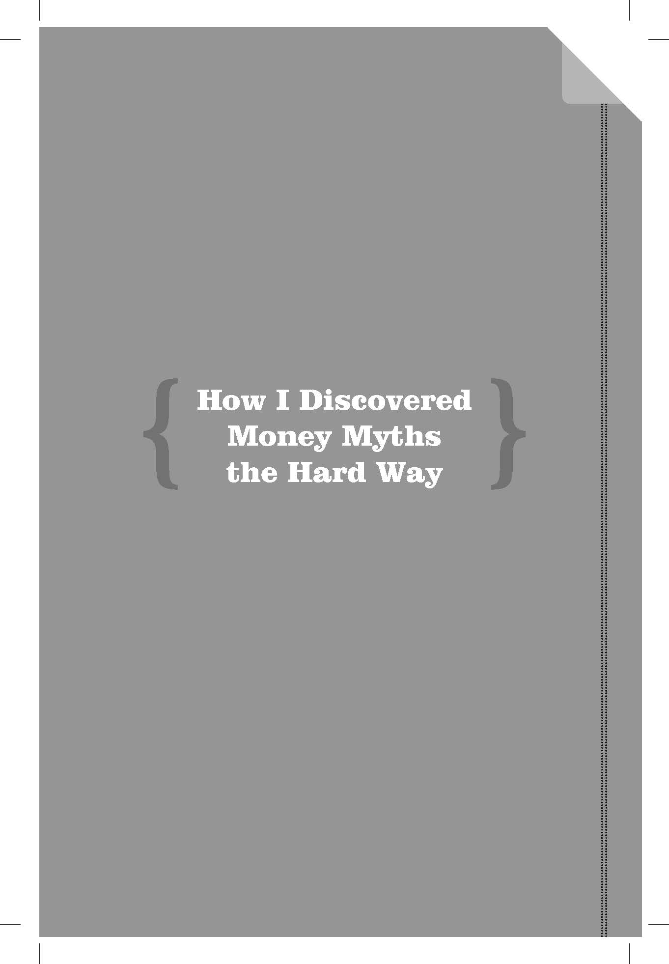

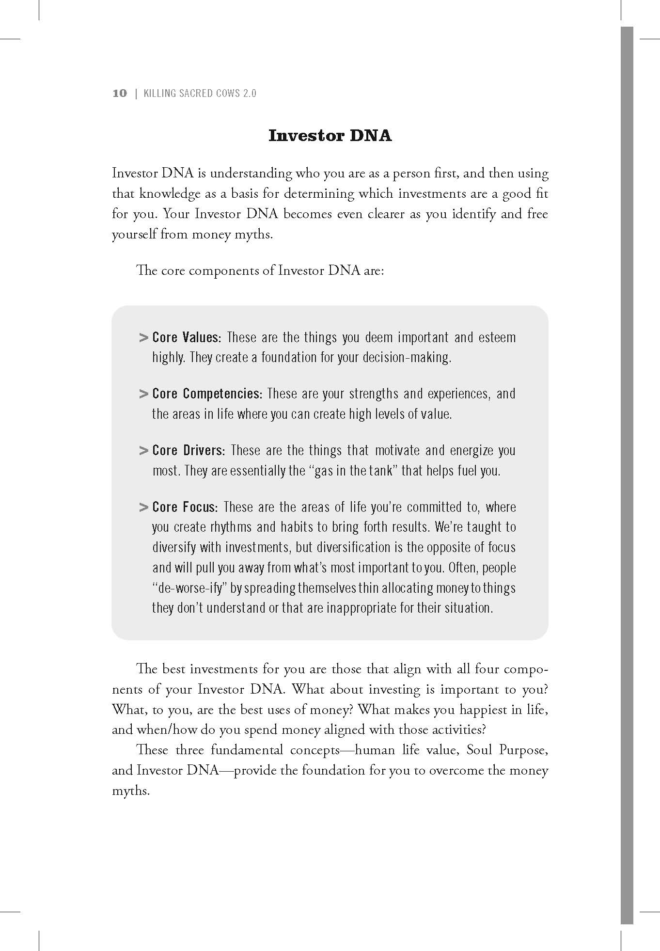

I didn't really know what to call this. The issue when you have an image in a PDF that bleeds. But then one edge of the image is clipped off at the crop mark (vertically), and shows up on the next page.
Is this an InDesign issue? I see it all the time with submitted files. We have the same problem here too.
Our normal InDesign process is to save a PS file which is then distilled to produce the PDF. Which results in the mentioned issue.
Does anyone have any input as to how this can be avoided? Is it Indesign screwing up, the PS process, or the distillation??
I know you all have had this issue pop up.. But what to do about it, is the question.

I'm quite certain this - at least in my content - is not an overlap issue. The pages content is always inside of the page dimensions.
It only seems to happen when an image bleeds beyond the crop mark, ON BOTH SIDES.. still well inside the page edge. And only on one side.
The side changes depending if odd or even page.

I'm sure many people have seen this. I just pulled a couple pages to show what I'm seeing in this particular supplied file. And I have no idea what others are doing to the files they send me. Yet I see this often. Have to manually go page by page, for those pages displaying the error, delete the clipped part, and stretch out the background or image to bleed properly.
I'm thinking the key may be that it only happens on pages where an image bleeds to crop marks on BOTH sides. But clips only the spine side. Almost as if the SW were trying (in error) to setup for a saddle stitch bind... Eliminating the image at the crop mark to meet a facing page at the spine. To be clear, I'm not making SS books. Just trying to comprehend/explain the problem. That does not explain why the clipped part ends up on the next (or previous) page.
