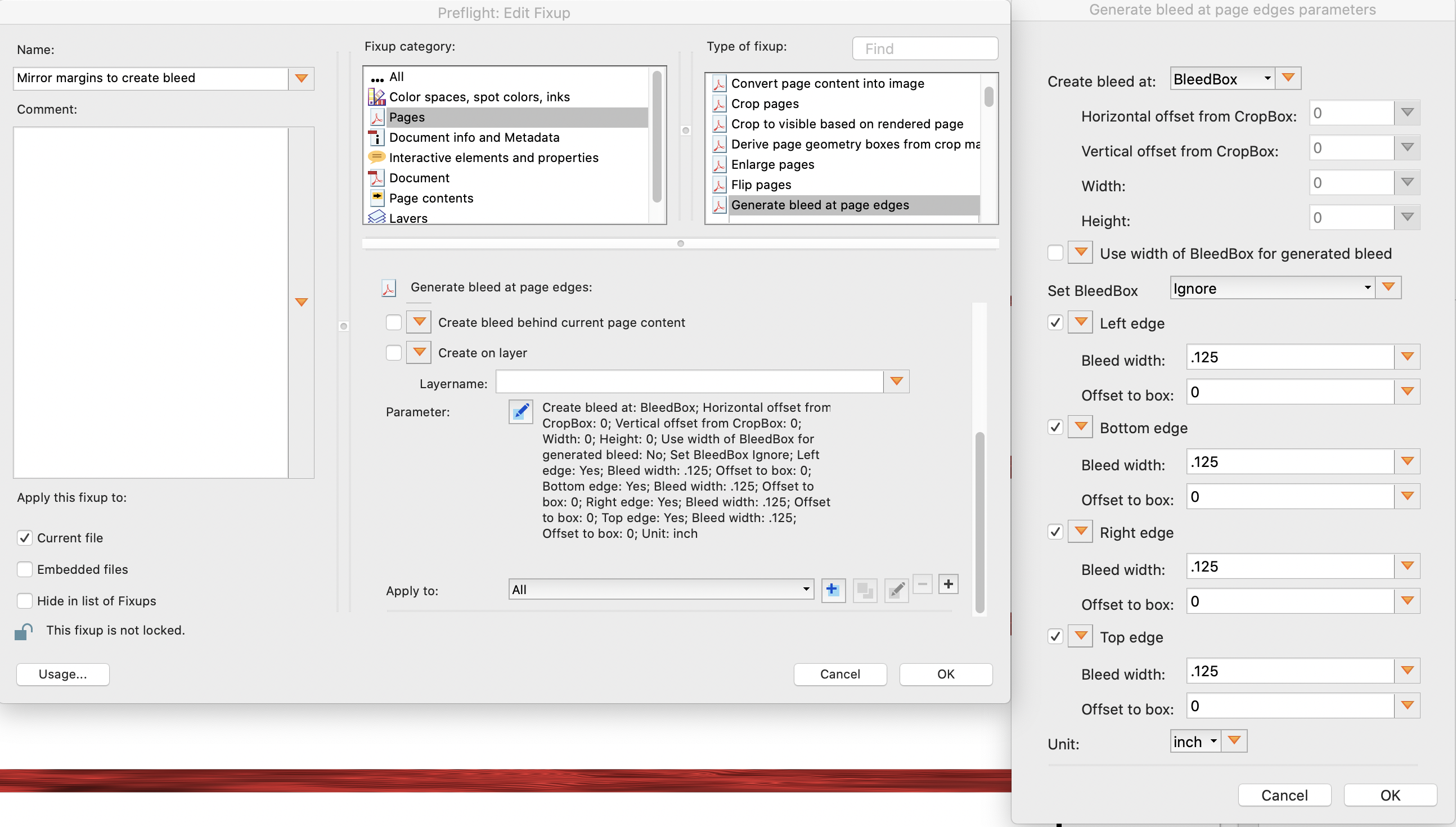

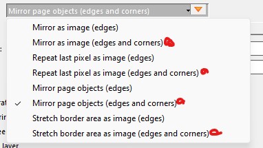

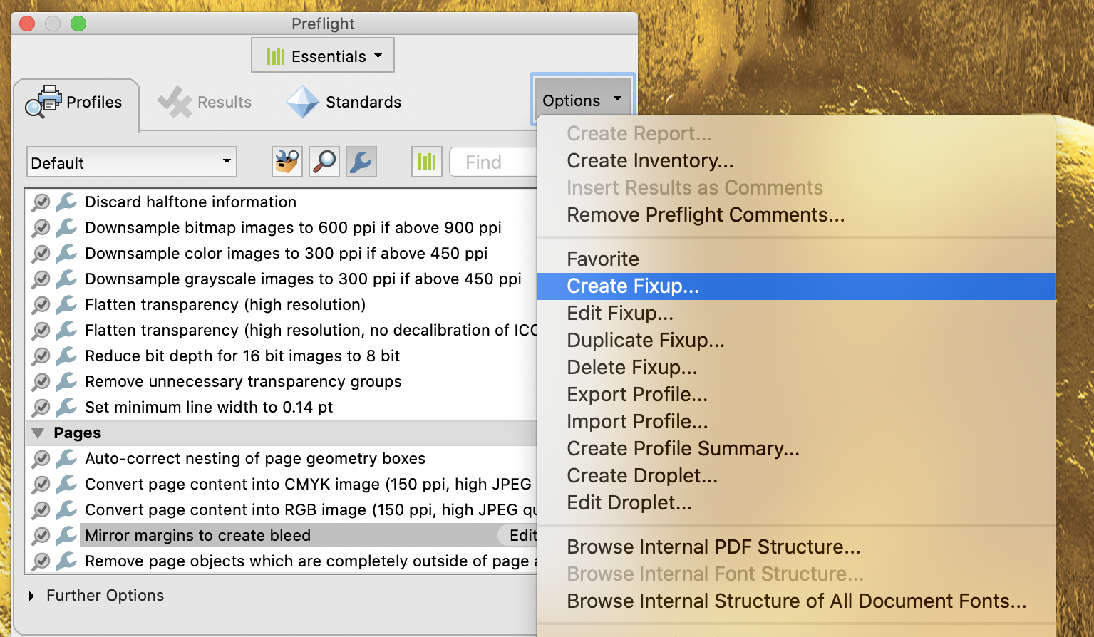

We have three ways we do this without using pitstop pro.
1) You can do the mirror the margin function with a fixup in Adobe Acrobat DC - this works good for longer documents.
2) We have a mirror margins script for Adobe Photoshop - this autogenerates the .125 selection box and then autofills with mirror margins if that doesn't look good you can then use content aware to fill it. The script for photoshop is one I found online. Happy to email it to you. It's just a few clicks.
3) We have a special desktop program that we hired someone to make (before we knew about the adobe acrobat option) that converts the file to a flattened image and mirrors the margins - it's okay but not best resolution but it's fairly quick on smaller files and always works even when someone sends a corrupted pdf file but it's a last resort as it's a memory hog.

Thanks to everyone for your suggestions, we have tried the adobe acrobat preflight with mirroring and it has worked, however there seems to be unusual white boxes at the ends of each corner (screen shot attached) bleed works perfectly but if anyone knows how to remove the white boxes, Id be forever grateful!

You need to use the option that says "edges and corners" and not just edges. There's four different options, You can play around with which of the options gives you the best result when generating a bleed.
