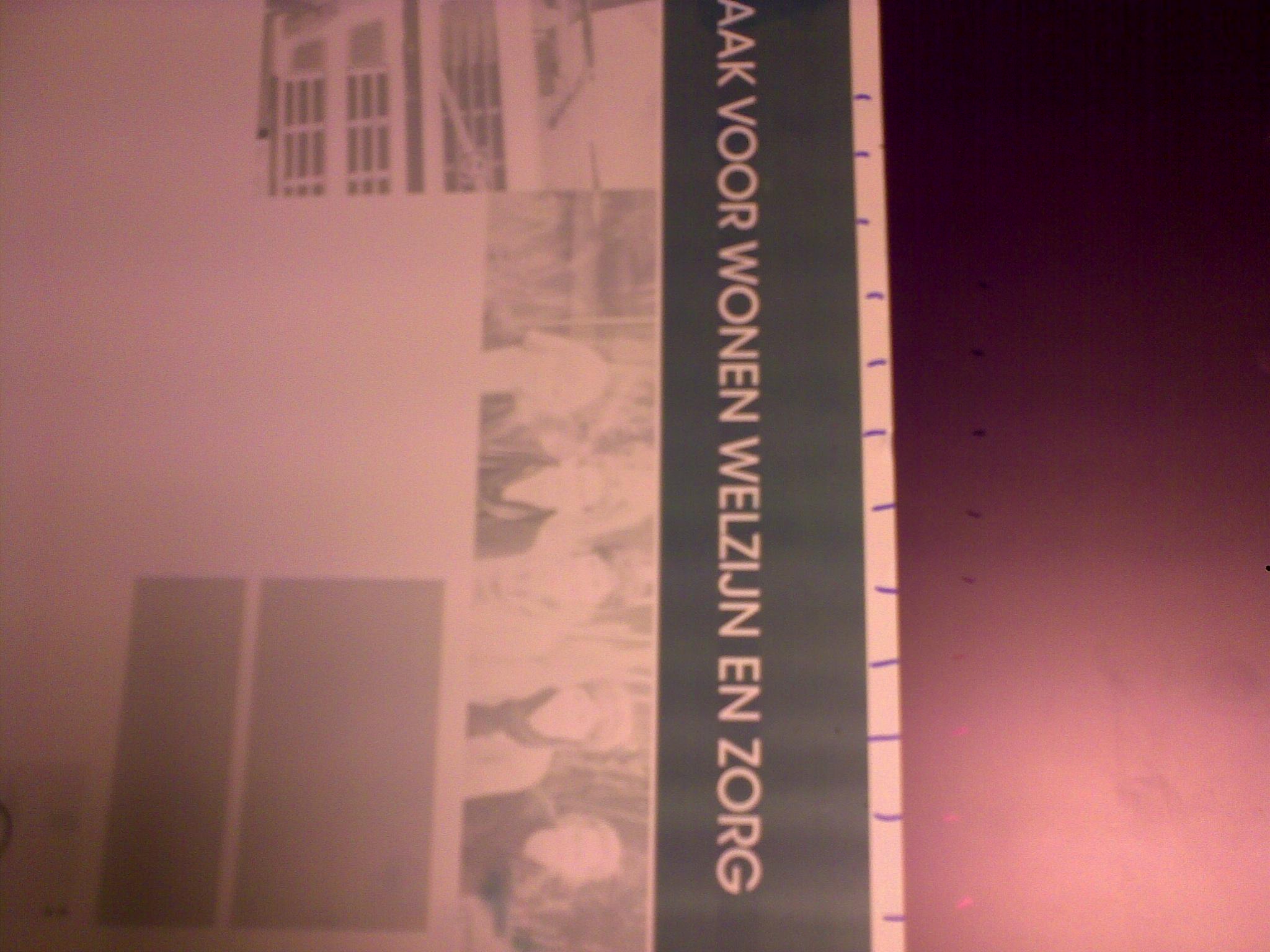

Here's an image of the difference
Be iinterested to know if it wsa the old chemicals or the fact that the chemistry was remixed. Using a fresh batch of new chemistry would have the same effect? If so then how is your chemistry re-plenished?
The left plate (best result) was with the old chemistry. Agfa keeps 10 x 20 liter cans on stock of each batch. So thats why they could send us this. The current chemistry is the plate on the right.
If i drain all chemistry and renew it with my current chemistry it still does not give the same result as the old chemistry.

We still have problems with blinding. As you can see on the picture the repeating lines are already on the Lap-v plates out of the box.
