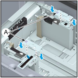

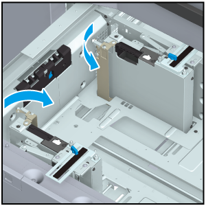

And no, you're not limited to peel & seal. However, I would strongly recommend you get side-seam envelopes when you start running #10 envelopes. We run #10 from the short edge, closed flap, and the flap towards the back of the machine. Make sure you have the envelope fuser for them, and you'll need to install the brackets (A) shown in the photo below, along with flipping out the "small sized guides". On a side note, the brackets (A) are very useful when running divider tabs. The hold the tabs into place so they don't blow backwards.

I'd be interested to see photos of how you're setting up the drawer @FLPrintShop . We have 3 KM 6136's and run #10 envelopes no problem...cases of them! In fact, we use the DIP switch that allows us to feed them out of multiple vacuum feed drawers so they can run continuously. We also run 6x9's, 9x12's, and 10x13's. When we run the catalog envelopes, we don't use the envelope fuser, we just turn off double-feed detection.

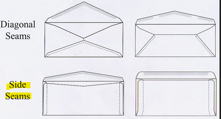

And as previously mentioned, if you're not using side-seam envelopes, they run MUCH better than diagonal seams.
