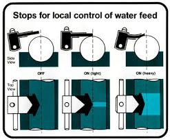

Used 'water stops' for many years on our web presses. Also used air bars (air curtain) on the rollers to reduce the amount of moisture on the ends. Water stops much cheaper and requires far less technology.
