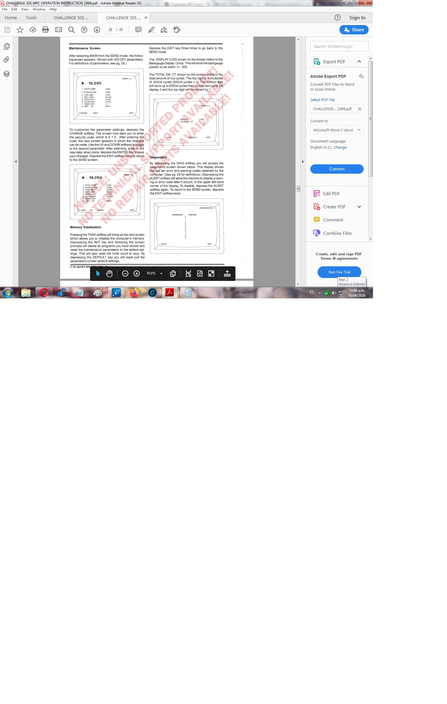

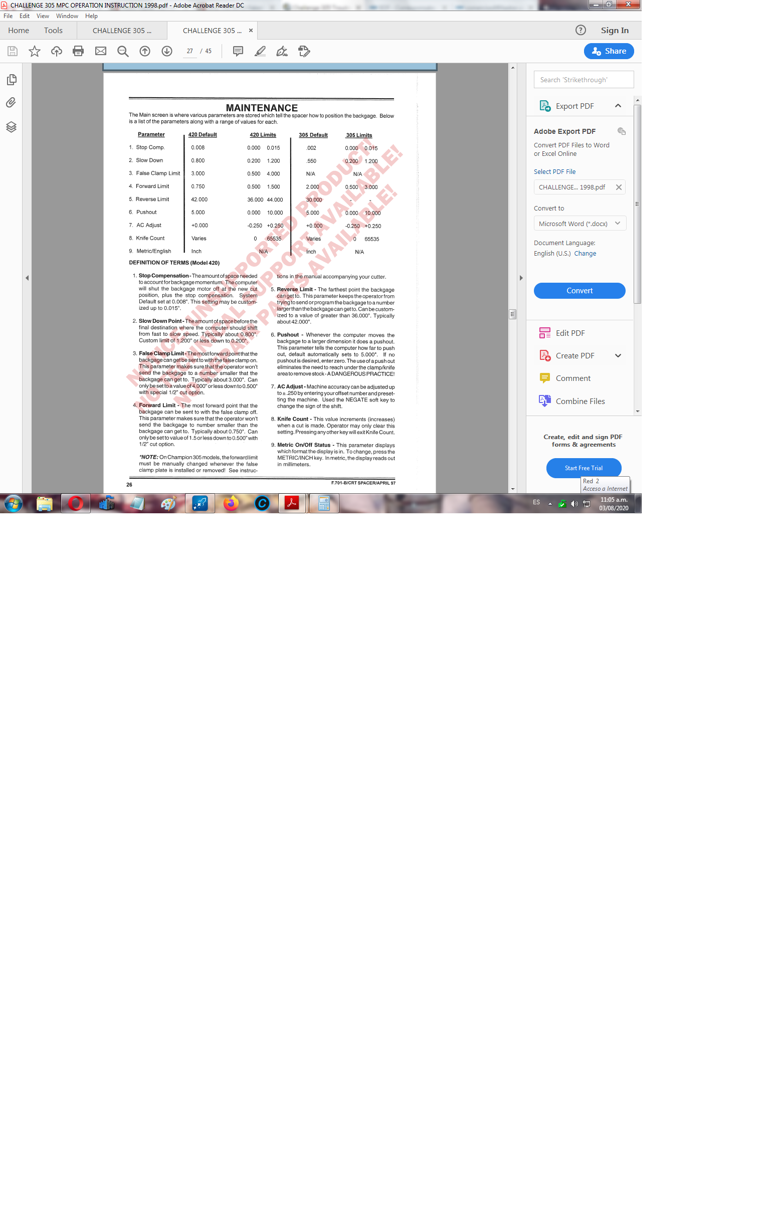

Please follow the steps attached, and fix it.
However test the battery for low voltage, can be the Big possibility, If you Never replace the back up battery, the information is Lost, and need to Reinstall the software.
Let me know, sincerely
Blessing

kdw - I had 1990's 305 MPX's. Every time we had a brief power outage, we got the 55" display. From what I remember, there were two separate memory reinitialize routines that we had to perform, just like the one in the 2nd page Chock showed. They're a little tricky to fully follow along with but they worked for us.

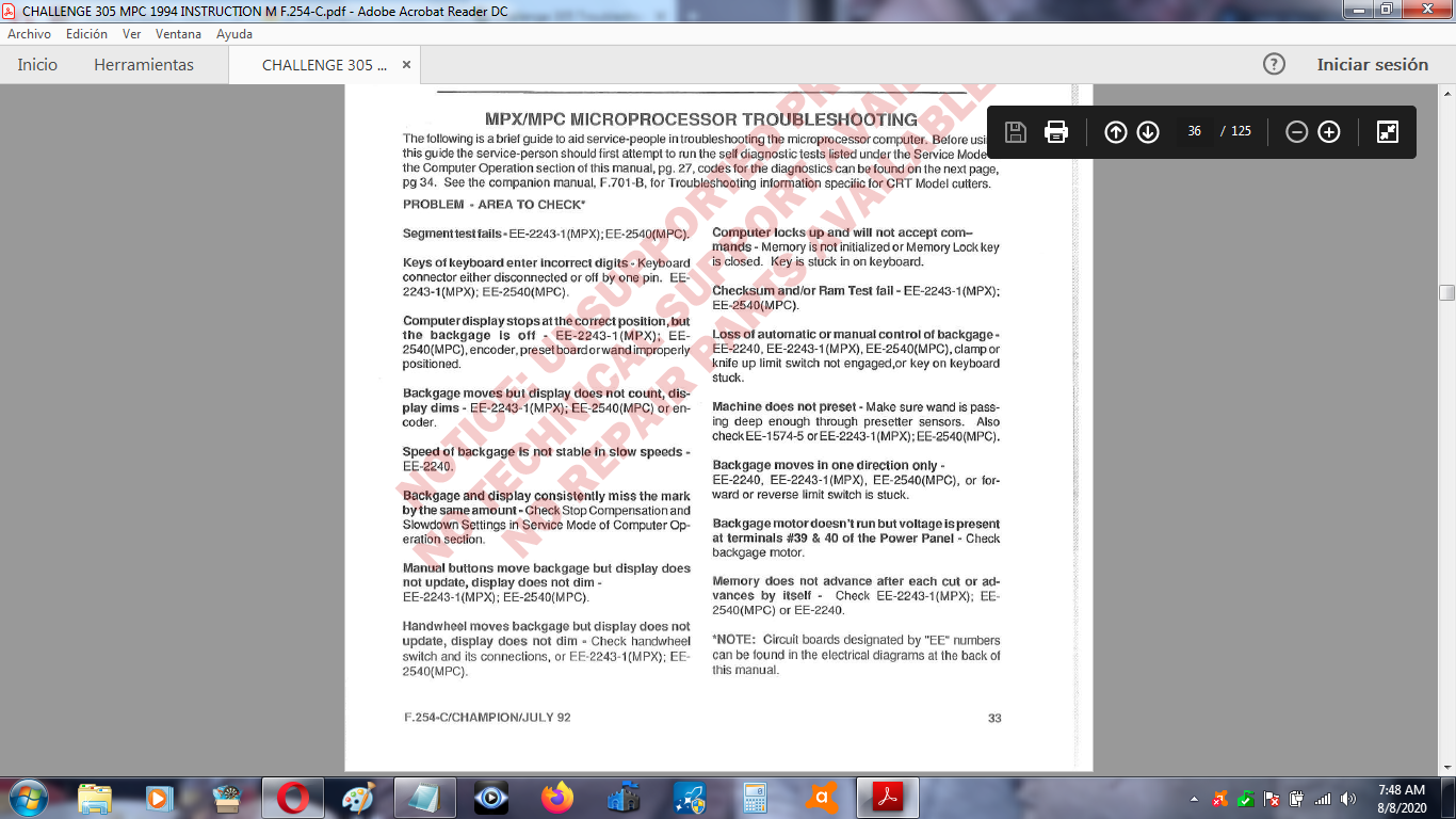

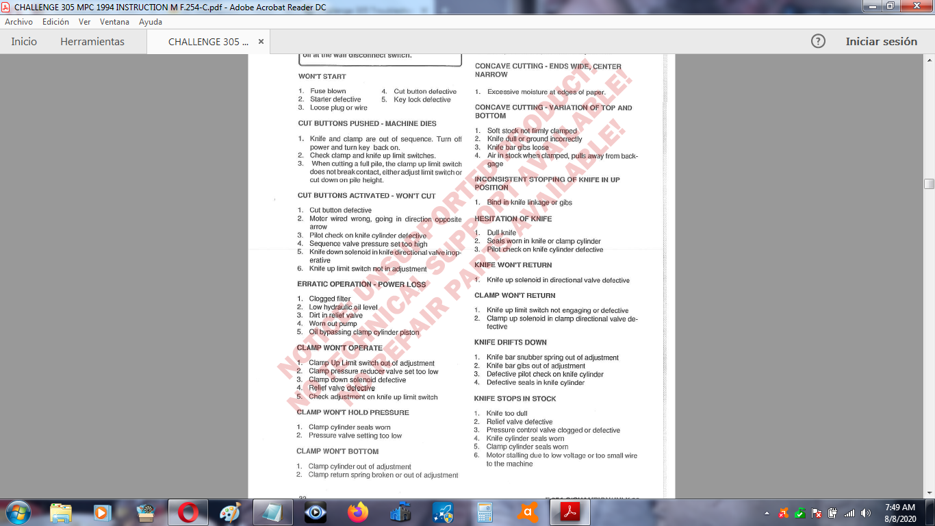

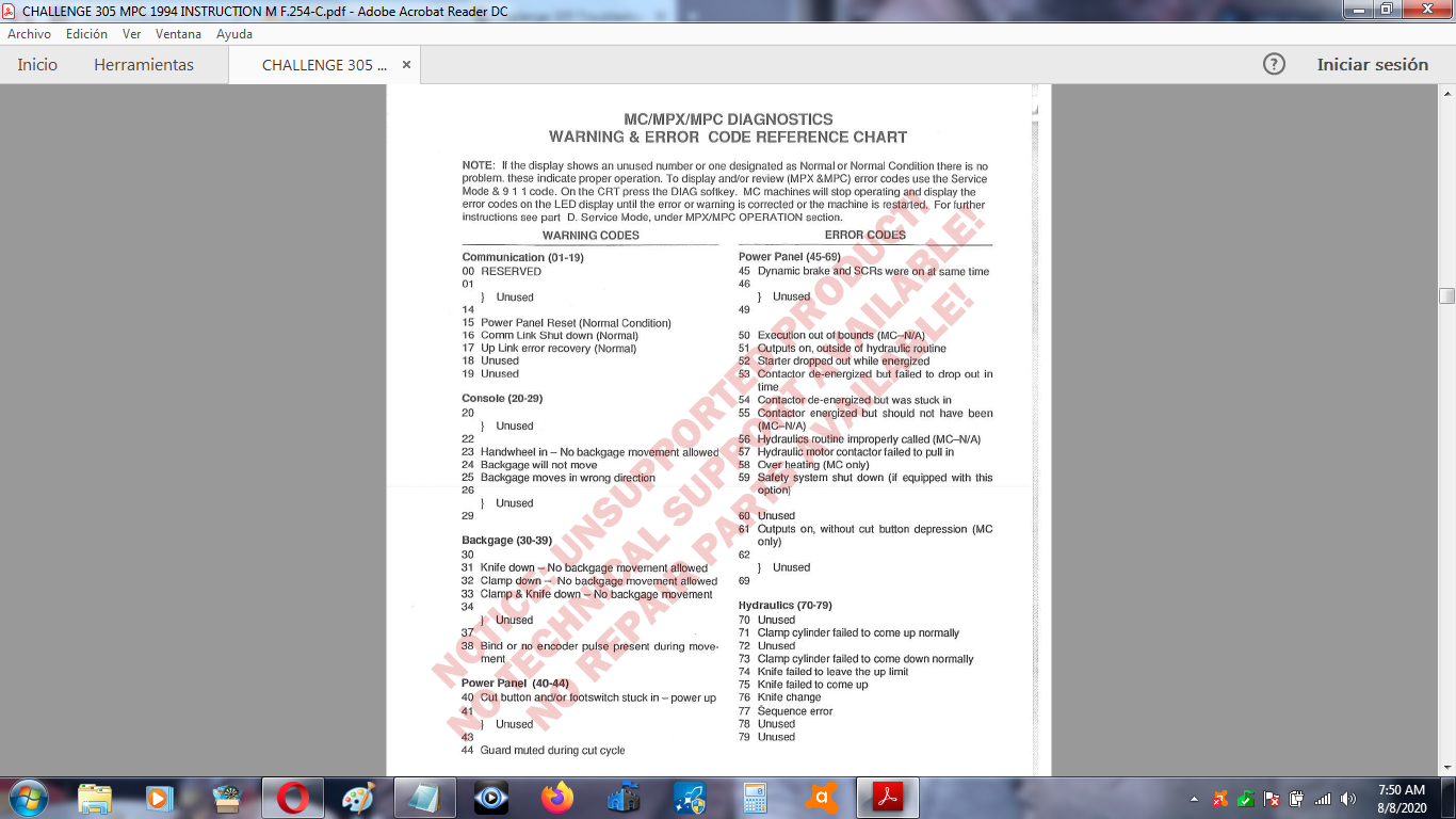

Attached is there 3 pages for troubleshooting, in according with the serial number 1994 year.
Hope you can fix it.
Let me know, sincerely.
