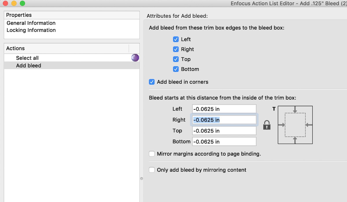

I have another issue I'm just not getting after hours. I need to add bleed but it seems to go so far into the page to mirror it, it looks bad. Any tricks to help with that? A set up that would take a 1/16 or less and slide the image, maybe? or any other tricks or videos to help us with the global bleed? thx for any input

If you are using the Pitstop add bleed action the number you enter for left, right, top, bottom works if you enter '0' it starts at the trim box. A positive number moves that far into the page from the trim box to start adding the content. A negative number moves that far into the bleed away from the trim box. In the example below it starts adding the content .0625" (1/16") past the trim box in the bleed area.

Just to reiterate what Joe said. The value is where the mirror starts from based on the Trim Box.
When we tested we often found objects that did not quite reach the Trim Box, so we added that value.
The one we use in our standard Action Lists comes very slightly into the Trim Box to resolve anything that might happen due to rounding differences.
