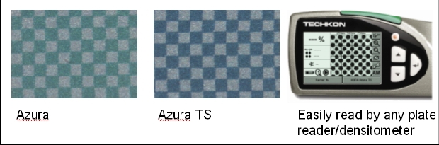

Basically - three things have changed from Azura to Azura TS:
Improved sensitivity, improved clean-out, and increased contrast.
- Imaging on our Acento 4-up platesetters, the imaging speed has increased by 50%.
- The improved Azura TS Gum has the look and feel of a traditional gum, and is more
efficient in cleaning-out the unexposed emulsion. It also now has a neutral pH of 7.
- When it comes down to increased contrast - a picture is worth a thousand words...
