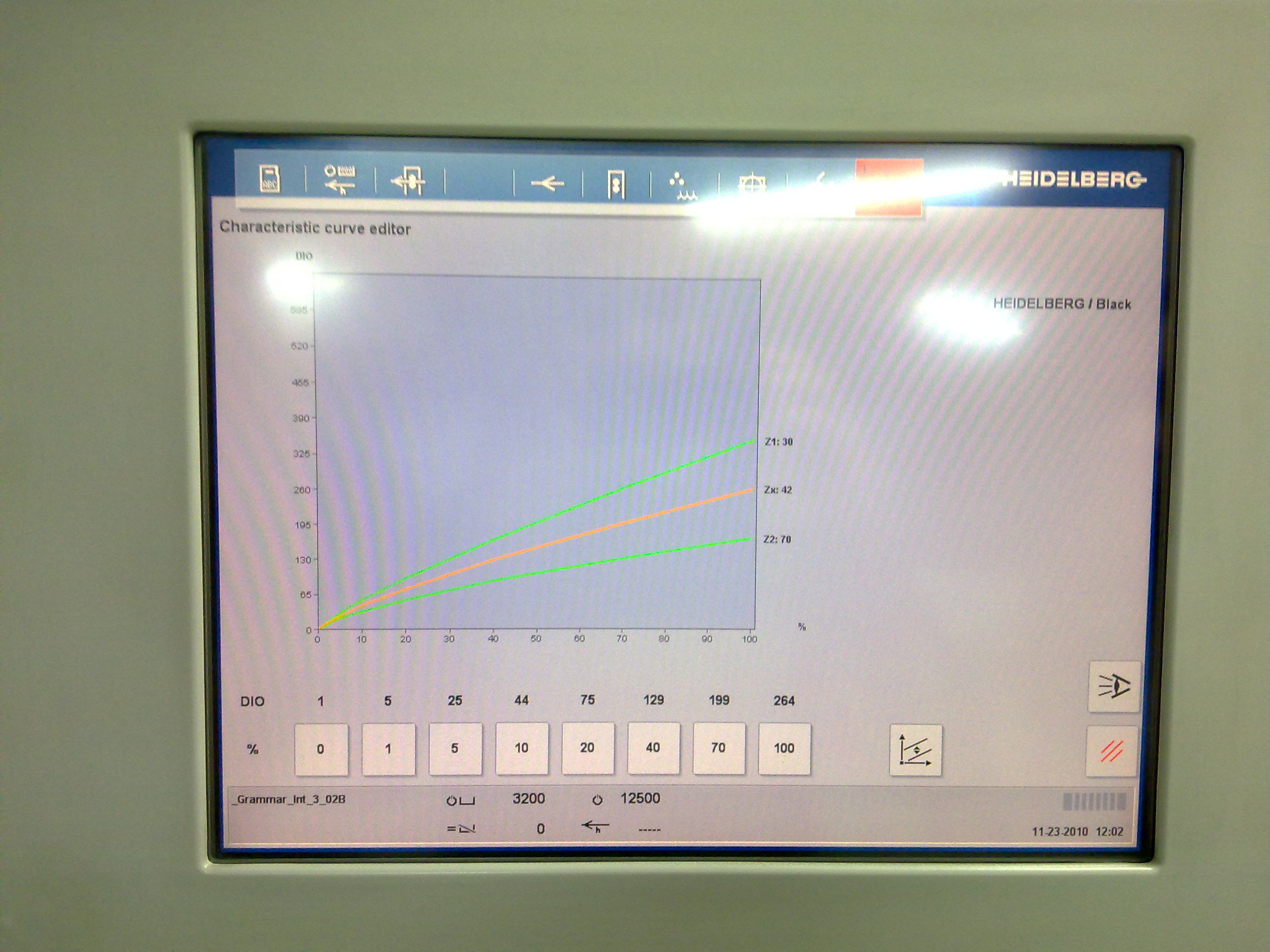

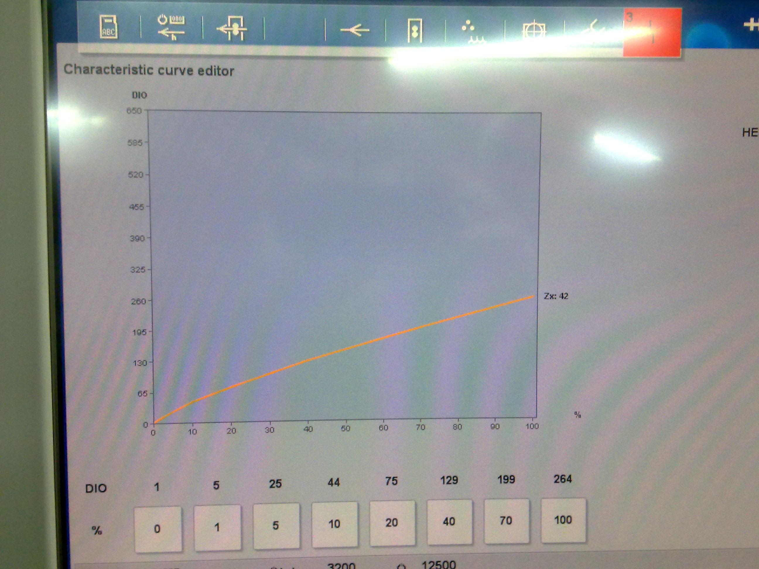

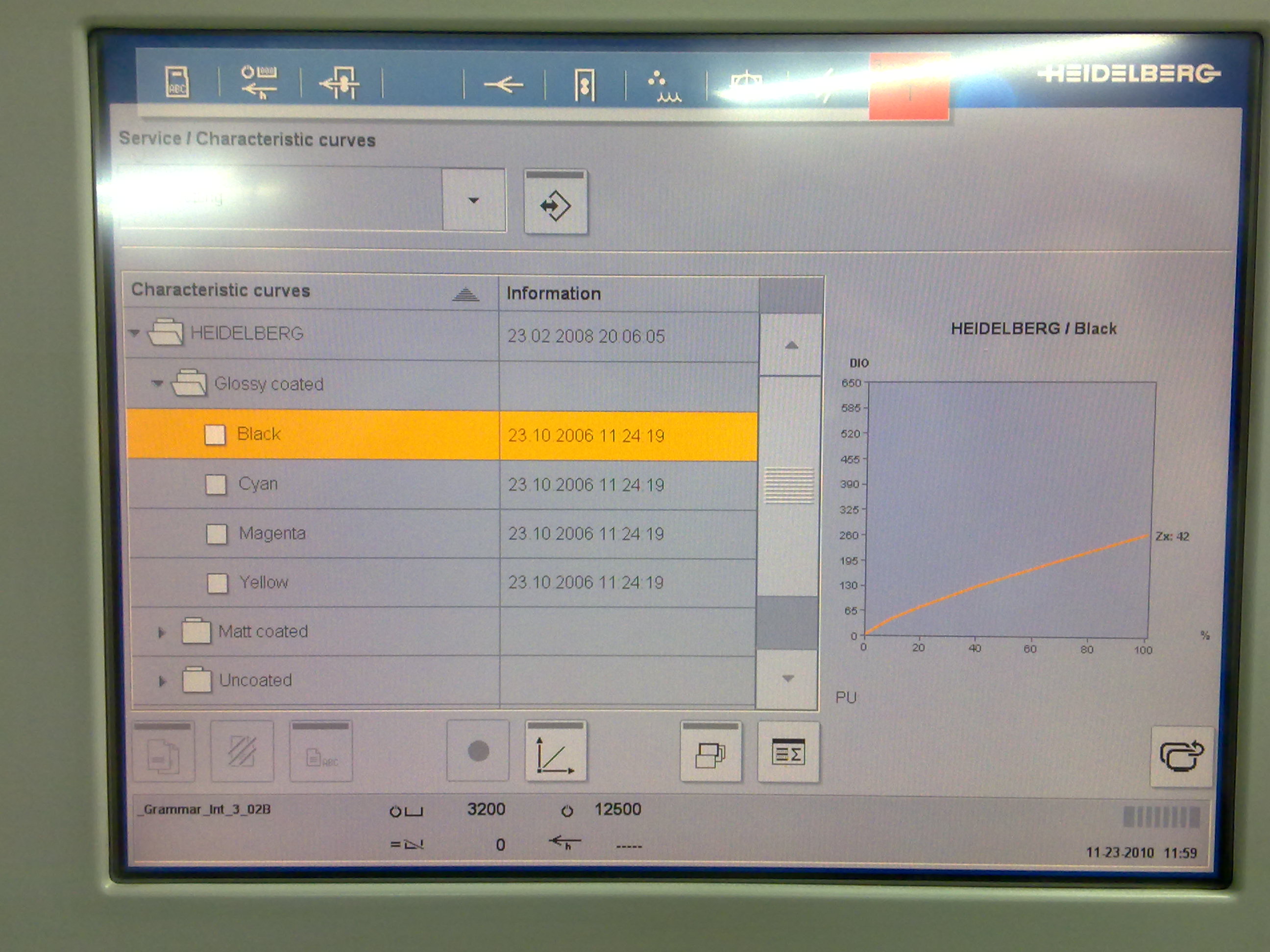

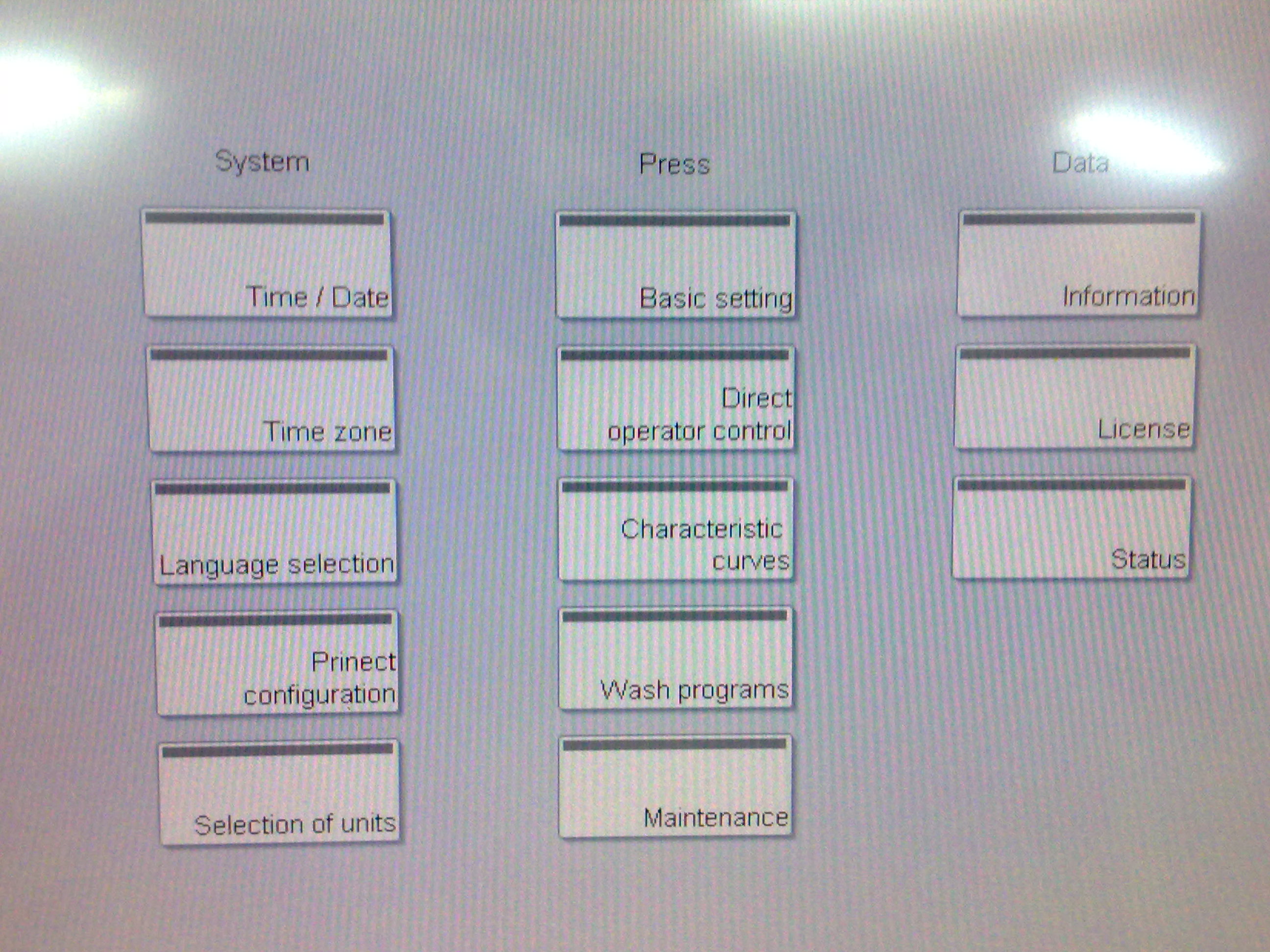

I have attached screenshots from our speedmaster CD 102. It looks like DIO is under characteristic curves.... is that what needs to be adjusted? or maybe a new curve should be created? so prepress interface or PressPerCent for the matter are not enough to get close to standard densities.

Your characteristic curves in pictures must be adjusted to get close your aimed densities. Your current curves set can be adjusted or you can create a new one. But adjustment can be done by a service specialist. Test jobs must be printed under ideal conditions and measured for adjustment. If you have Color Assistant option you can do adjustmet yourself by pressing just one button but this option works better with Axis or Image Control. In my experiences the curves which were created with Color Assistant in cooperation with Axis/Image Control always provided more accurate and balanced densite values than manuel adjusted curves.
As Bloodsaler said different brand machines are using different names for same function. I just mentioned CIP3 calibration curve. You can also find speed compensation curve under same menu.
Regards
