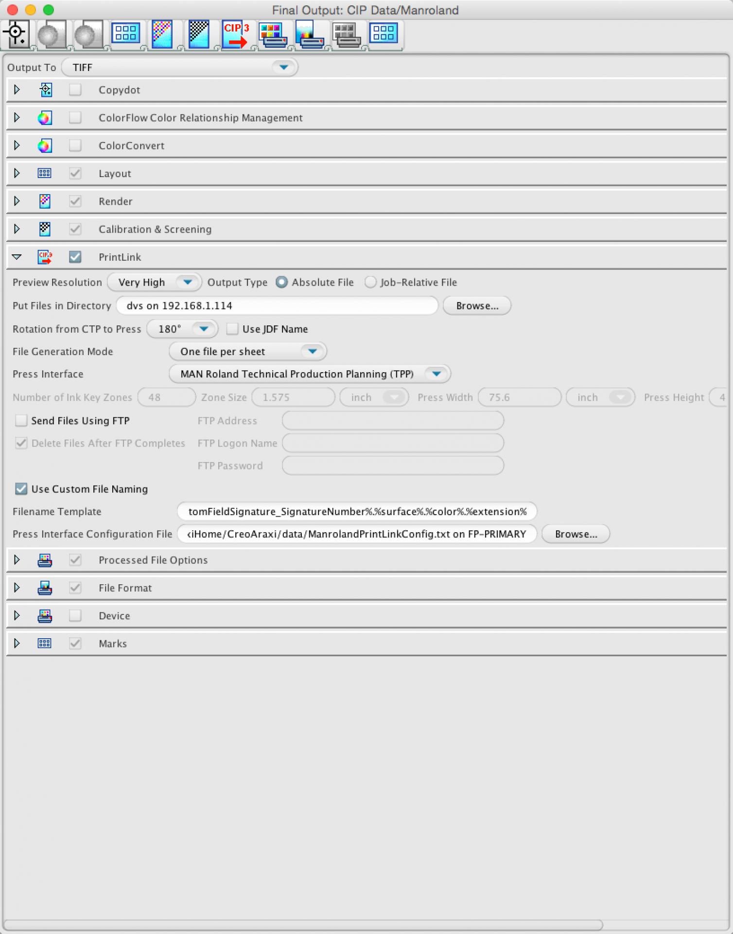

I believe Manroland's structure for Cip data is slightly different. We have a newer press and had a similar issue at start up compared to what we send to our Komori's. I am not sure if this will help with your press. If not, you may need to contact Manroland.
https://screencast.com/t/jFvykMDt
txt file we use for Press Interface Config File attached
Thank you,
John

Did you get it work?
Here is my screenshot
