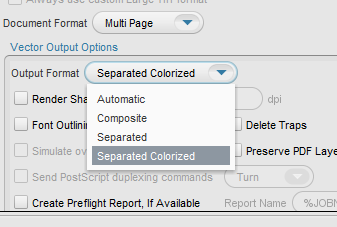

Does anyone have a workaround to create a separated PDF that prints the separations in the color that is called out? I can generate a separated PDF, but the individual colors are in black and white. I would like for the separations to be in the color they will ultimately print with. A Pantone 185 separation would be red and a PMS 130 would be yellow and so on. Ideally, this would result in a multi-page PDF that has a page for each color. This would be used in much the same way viewing layers is. I'm stumped.
Depends on your workflow, Prinergy has the option to output "Separated Colorized"
Macmann
Yeah I can do it in Esko too-I'm trying to dumb it down for clients who just have Acrobat Reader. I thought I could use the Adobe PDF printer option or InDesign but I'm whiffing on all attempts.

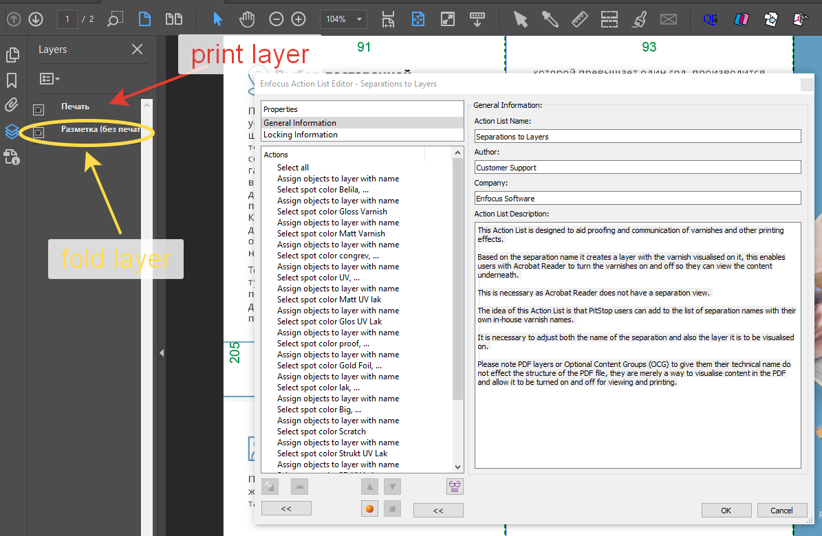

trvds
Для аналогичной задачи я использую действие Enfocus PitStop. Возможно, это будет решением и для вас. Особенность: много Pantone = много линий в действиях.
