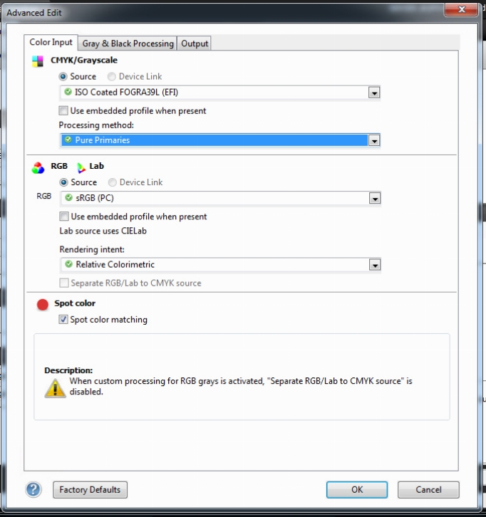

Photos on my J75 are looking washed out. Normally we don't use it to print photos so it's just something I've lived with (mostly line art and text with small pictures). I'm working on one specific file right now and it looks fine on my computer but it just looks washed out when I print. Any tips besides color calibration?

-For the images, the indesign file and the resultant pdf file, I'm using an icc profile that I saved from the color profile we are using on the J75.
-I go to Fiery Workstation and then drag and drop the file into the hold queue or sometimes I will print from acrobat to a print driver I have set up that sends to the hold queue. Once in the hold queue I go to Fiery workstation and configure settings as desired.

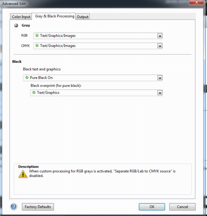

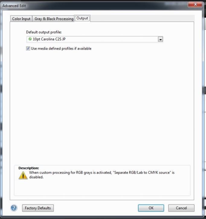

-Screenshots of color settings included below
I would change your CMYK rendering to Relative.

Thanks for the feedback.
I'll try switching to GRACoL and Adobe RGB... For the fiery color settings should I then change the "CMYK source" from ISO Coated FOGRA39L to GRACoL? Also, I'm not seeing a place where I would change CMYK rendering to Relative, do you mean switch processing method to "Full (Output GCR)"?

Yes to all of your questions. You're in the US so GRACoL or SWOP would be recommended over any FORGRA settings.
