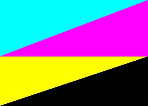

I was just perusing this thread - and a had a thought. It looks like you are (or were) having trouble nailing down what SIDs to run your ink set at.
Have you tried running a form like the attached? You want the density to vary - really you want the density to progress - across the sheet. If you run even ink keys across the sheet, the mechanical take-off of the ink should give you a density progression across the sheet for each color. This way you can check a bunch of densities all at once, and you can create a high-low graph to see what kind of tolerances you have with this ink set.
Something else to think about, it's been my experience that the overprint colors are more important than the primary solids. Get C+M, C+Y, & M+Y to conform within the 5 deltaE window.
Anyway, just thinking out loud.
