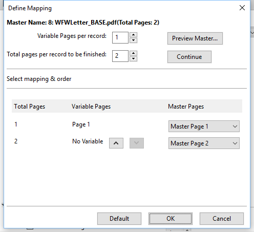

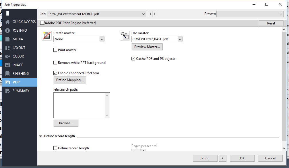

Very easy. Make a file for your master with page 1 blank and common back as page 2. Create your master as usual in CW. Your variable file is all fronts. No need for a back page. In CW for your variable file go to VDP, select your master, check "Enable enhanced FreeForm" and then click "Define Mapping". Variable pages per record = 1. Total pages per record = 2. Click continue. Below in Mapping & Order: 1 = variable page 1, master page 1; 2 = no variable, master page 2. You are ready to roll.
I (unsuccessfully) tried this months ago, and will retry following these steps. once it works, Making these your default settings should make printing the files as easy as a right click.
I got this to work. Thanks for the tip!
