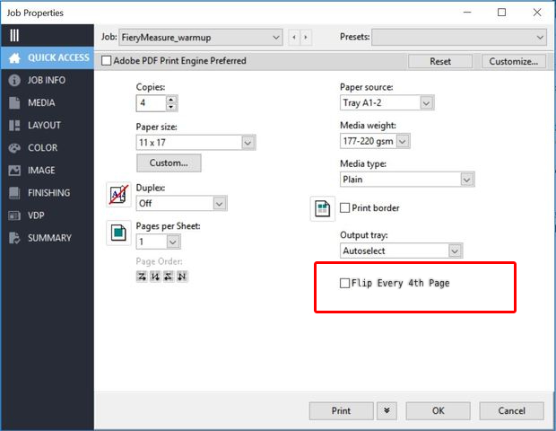

You probably just forgot to uncheck the "flip every 4th page" option. 😜

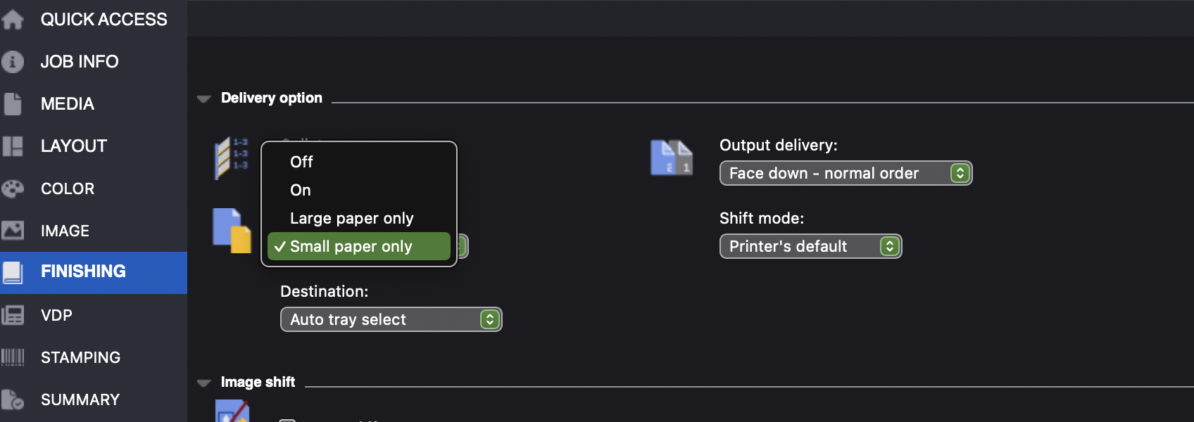

You jest, but this reminded me of an odd Fiery setting I've never used that could be contributing:
This is the "Rotate 180" setting in the Finishing tab. I've never used it, but I'm curious if something like this is enabled by default on your Fiery.

The "Rotate 180" command is set to Off by default on all of the computers, so no dice there.

Even more bizarre: the issue seems to be related to the delivery end. If the destination is set to "Auto Tray Select", then SOMETIMES it flips every fourth page. If the destination is set to "Finisher Shift Tray" then it seems to work fine? I'm absolutely baffled on this one.
