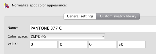

This would probably be easier with Enfocus Pitstop, but here's one possible solution with Acrobat:
Create a preflight fixup that redefines the alternate color of the spot color (to CMYK, with values of zero for CMY). Unfortunately, this forces you to do a complete resave as fixups always do. I tried to combine it with a fixup that then converts the spot color to process, but it seems to always do the conversion to process before changing the alternate color space. Attached are screenshots of example fixup settings.
