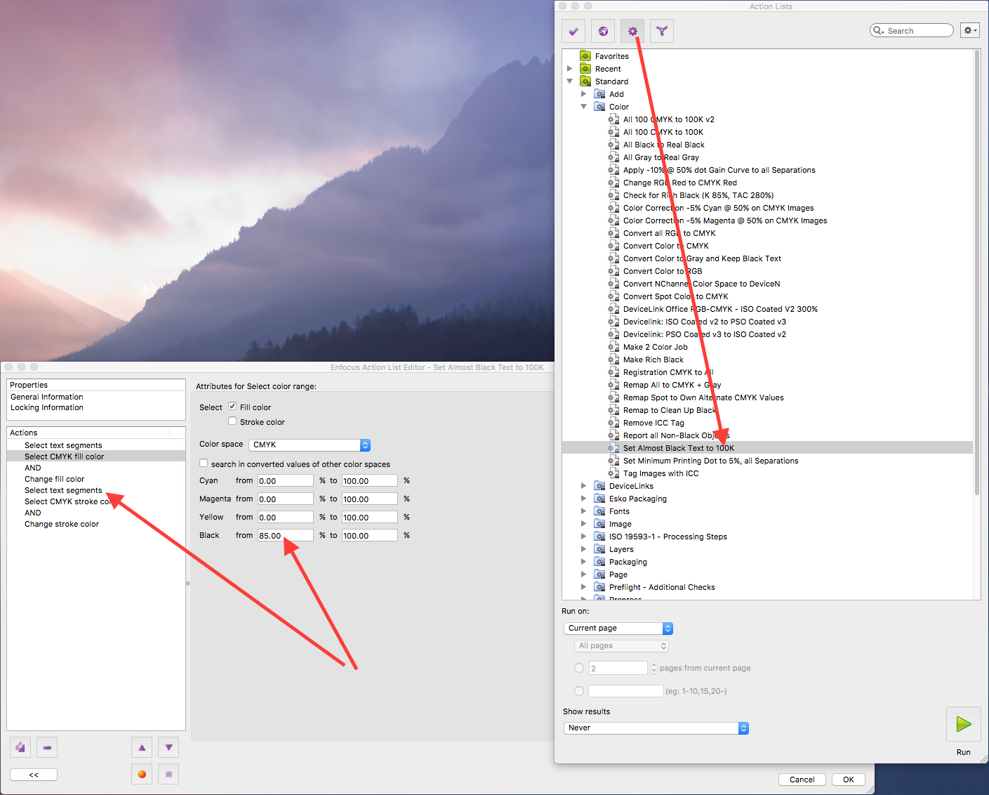

the above pitstop version has an action set up already … entitled “set almost black text to 100k” … the 'action' is located within the 'color' group. default value conversion already set from 85%-k to 100%-k values … targeting text elements as well. seems to me a slam-dunk … could either run it secondary or simply integrate it within your existing action.

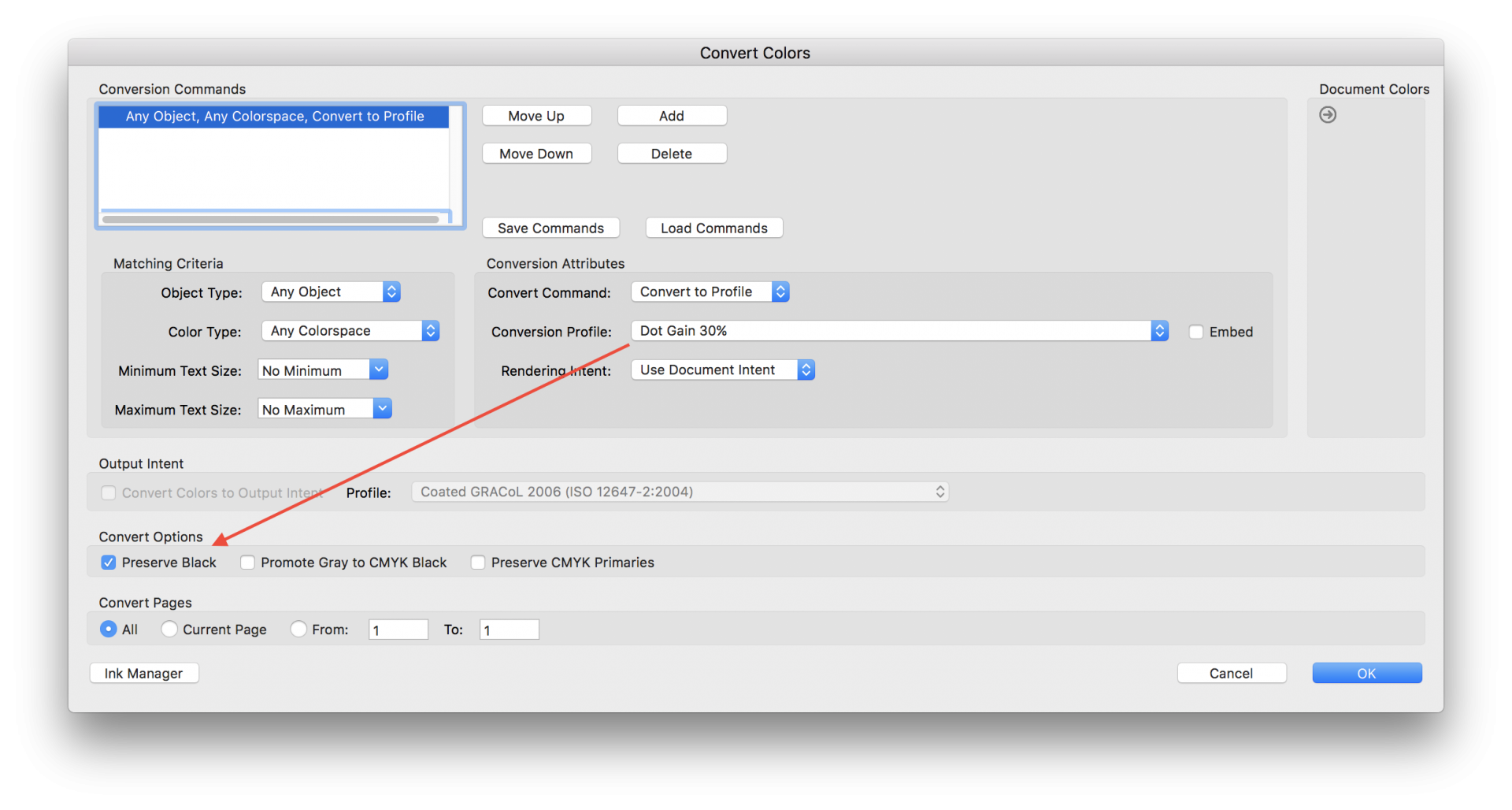

take note … acrobat does have this covered already … converting color to grayscale … while respecting black text … acrobat/tools/print-production/convert-colors interface.

Click image for larger version  Name:	Screen Shot 2018-02-22 at 10.22.19 AM.png Views:	1 Size:	663.2 KB ID:	273501Click image for larger version  Name:	Screen Shot 2018-02-22 at 10.37.50 AM.png Views:	1 Size:	504.1 KB ID:	273502

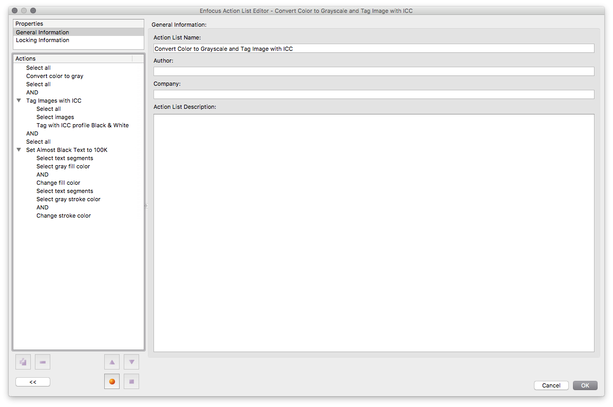

Ok. I thought I was out of the woods, not so.
The action works fine if I use it in Pitstop, but when I put the action into XMF and process the same file, the black that was converting to 100% is now converting to 87% black.
If you want you can move this to the Fuji forum. I'm not sure why this is happening.
Here is a screen shot of the action.

Before you convert the text use the 'override color management' action and turn color management off.
you can also save the settings before you use the override, and then re-instate them at the end of the action.
