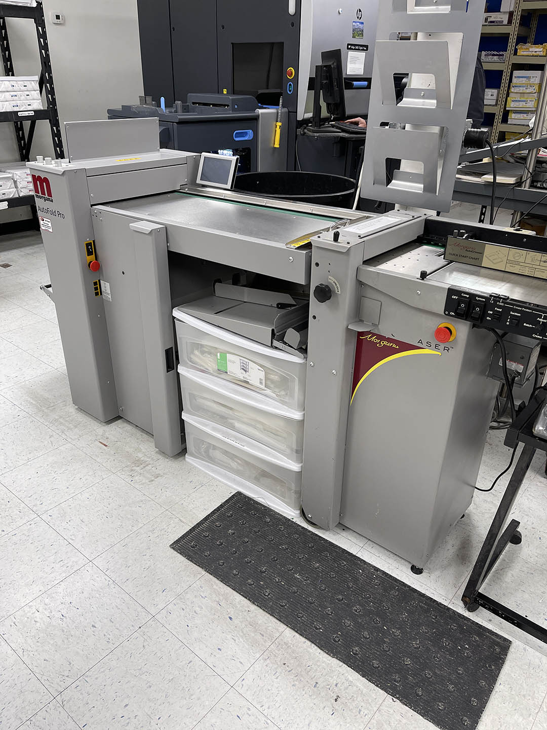

axelmk
We have an old Morgana Autocreaser that is 17 years old and it works fantastic, we score 350 gsm all the time and up to 24pt tango.
We have a Morgana Autofold Pro (7 years) next to it which will fold 80#, 100#, 111# & 350gsm on it without a problem.
Would buy Morgana again anyday.
Hope this helps.

Would love more photos of your print shop :)
