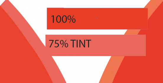

Have a look at the attached screenshot. I put a block of Special Orange at a 75% tint next to the shapes. The colour looks ok compared to the Special Orange with 75% transparency
The printed sheet will be printed will a screen of dots at a 75% tint, not as a "transparency"
On screen you are looking at RGB interpretation of a CMYK "transparency" and a spot colour "transparency"
​​​​​​I think the difference is just the software trying to render the image.
Print your job to separations and I think you will see it is just fine.
