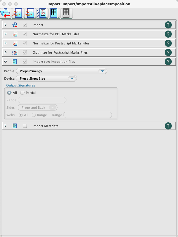

Check and see in your import template that the PrepsPrinergy Profile is selected.
