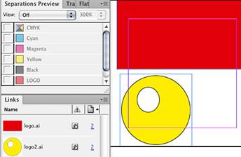

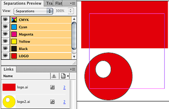

I believe Adobe was forced to do this, Corel did this 3 years ago. Yes conversions aremore accurate but in my opinion the best reason for this is that this should be the final move. These conversion specs have changed so often that there was a need for a final target LAB is the best choice, still the transitions have been painful!
AFAIK, the spots in placed PDFs (or EPSs) are NOT remapped during "normal" PDF export - they would be left alone. So if you had CMYK-based alternates in the original and then exported, you would still have CMYK-based alternates. Also, if you have different spots of the same name, they will also be left alone.
HOWEVER, if you are exporting to PDF/X (any flavor), THEN we will remap (and consolidate) the Spots due to the PDF/X rules.
Actually not entirely true. If you place one PDF with a red square called "My Colour" and then a second PDF/EPS with "My Colour" where this time it is green both will be red in the PDF, but if you print on a non PDF/PS compatible printer you will get your original colours (unless simulating overprint). I can send a file if you like ;) Skärmavbild 2012-11-20 kl. 20.32.47.pngSkärmavbild 2012-11-20 kl. 20.32.58.png
