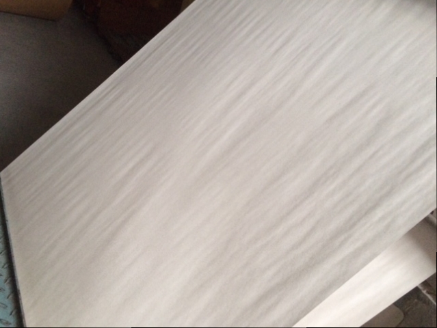

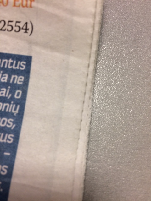

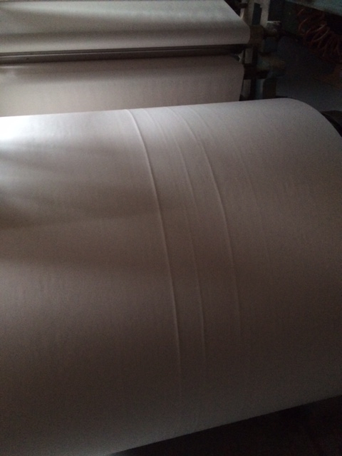

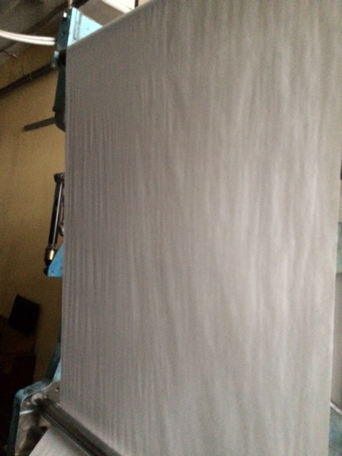

Hey guys:)
The adventures are still goin. Well, we got the new rubber from Germany. Will change all of it, will see what we are going to get.
Has one ever seen such "effects" with the newsprint paper? I think it is the cold and wet where the paper is being kept. What do you think, guys?

Hello magnetas,
You are always going to get "Trouble running" Newsprint that looks like that !!! (Pics)
How and where are you storing the Reels (Rolls) ?????????
The newsprint is Damp and lots of "Moisture Welts "
