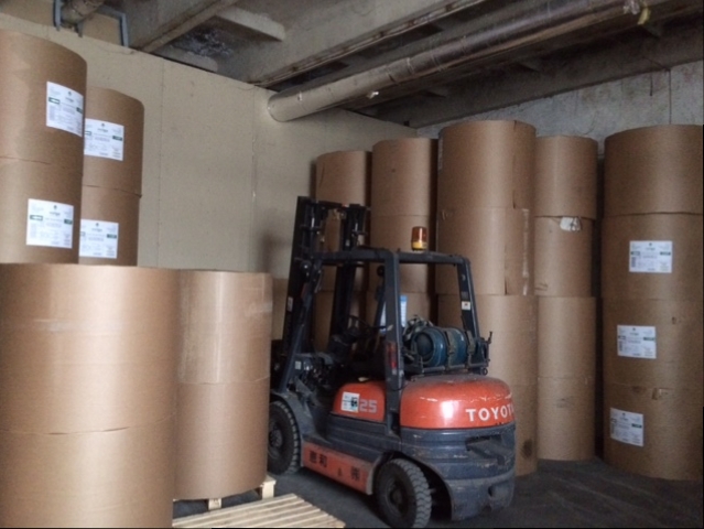

Hello Alois,

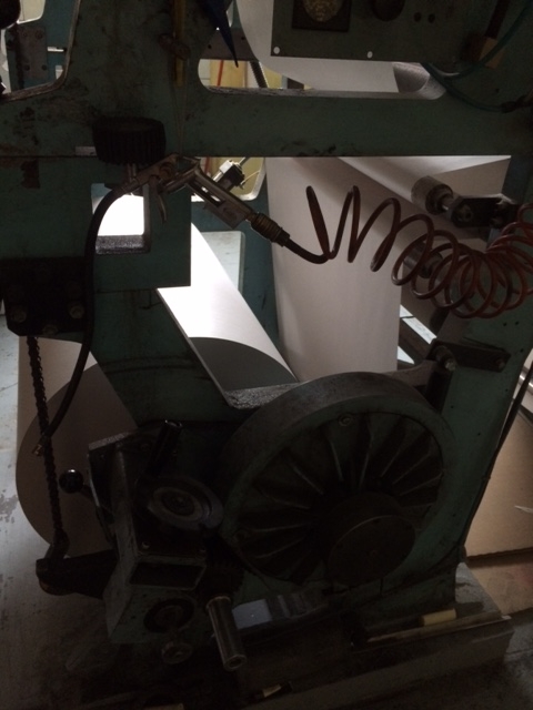

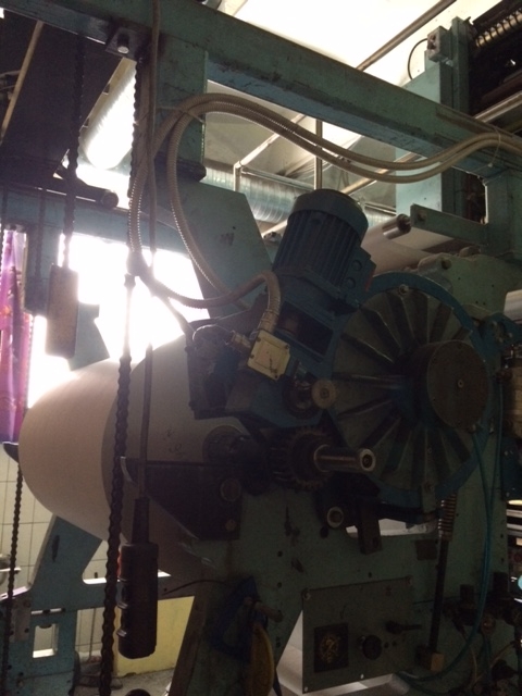

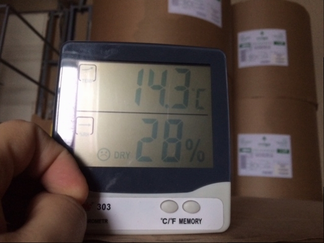

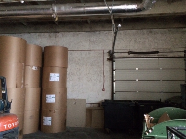

The paper is being stored in a storage, which is cold and pretty wet because of the cold. (Attached some pics). Only one thing divides the place from outside - the gate, which is opening upwards and it is not stopping any cold or smthng like that.
Two or three days before the print (depends on how many newspapers we have) some reels are brought inside and kept by the machine, so that the paper could warm up. But I believe, it is a total nonsense. Am I right?.. 'Cause the people here are telling me I am not right and everything is ok - when it is obviously not. Alois, what do You think?

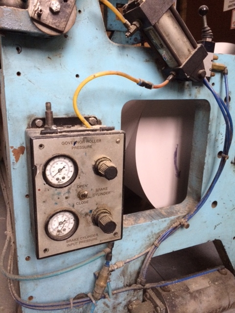

I do not believe we have Infeed tension control, the only tension is coming from the folder.

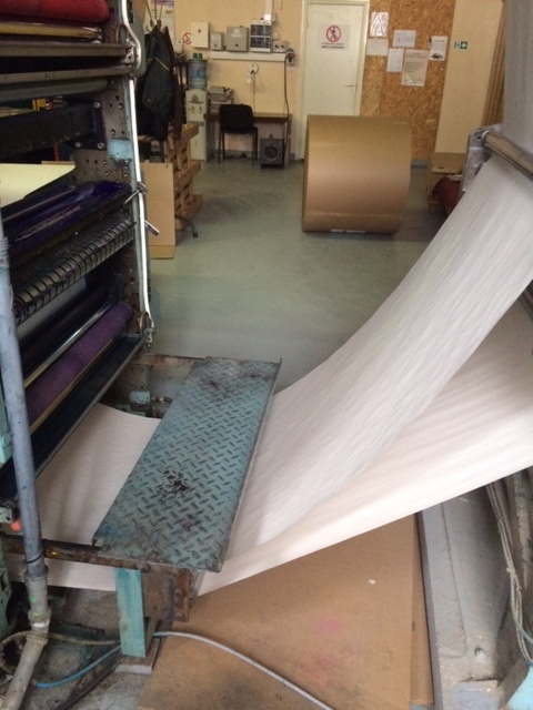

Hello magnetas,
Obvious from the pics that the paper is stored in unsuitable conditions .... the unwind views of the
web entering press unit confirm this.
Paper storage should be as close to the Pressroom temperature/humidity as possible.
DO NOT store the bottom reels(rolls) of the stack ON FLOOR .... store on pallets.
In extremely cold winter conditions, paper can take up to 14 days to achieve ambient temperature
throughout the reel (roll)
Regards, Alois
magnetas, Your press tension level is set via the Dancer setting, which in turn controls the reelstand brake,
which controls the web only into the 1st press unit. This is NOT A GOOD SYSTEM if you want control of colour register.

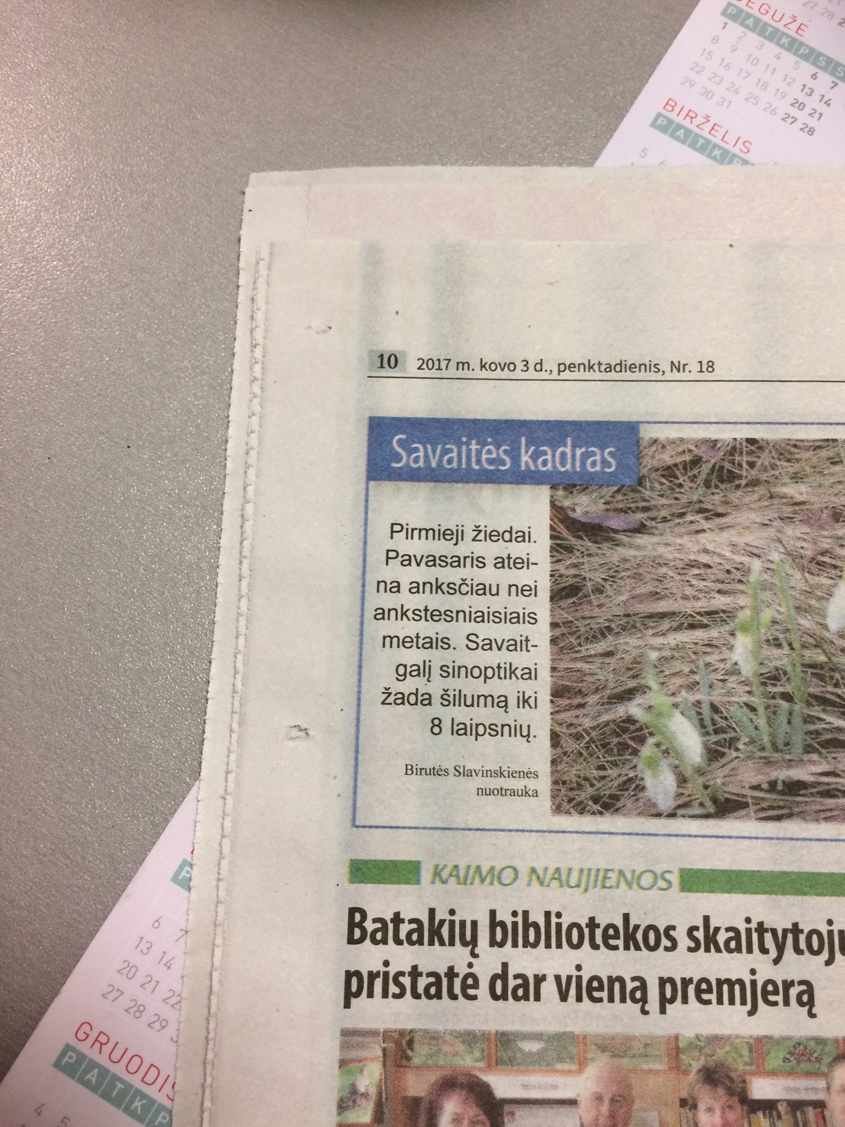

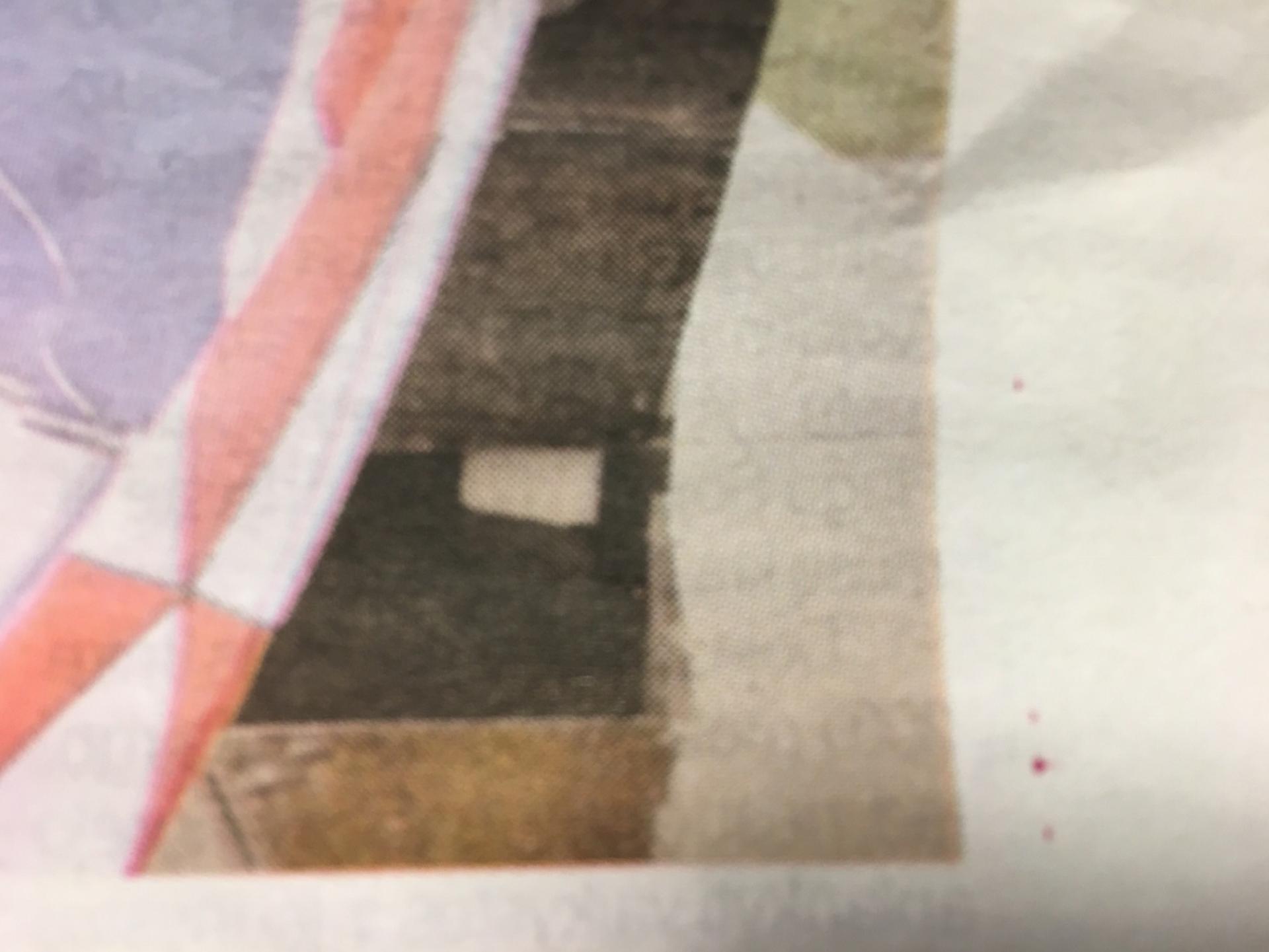

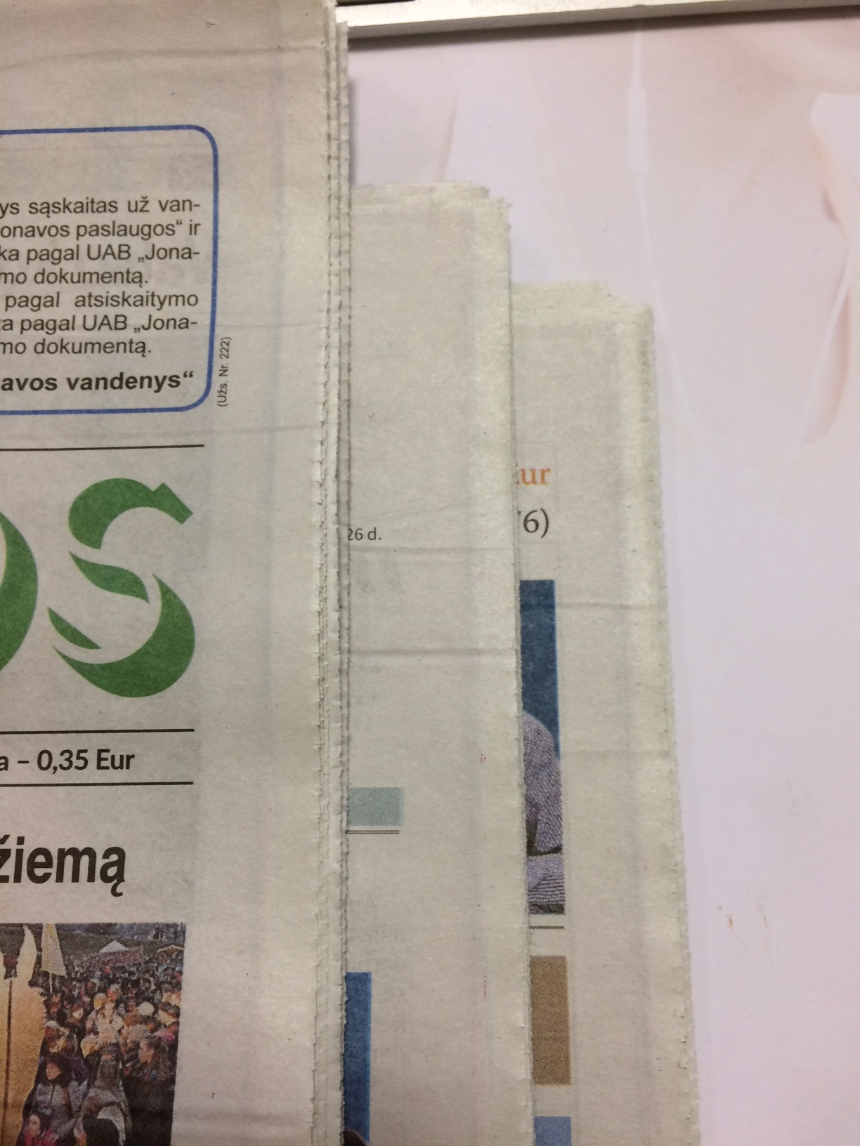

Hello magnetas,

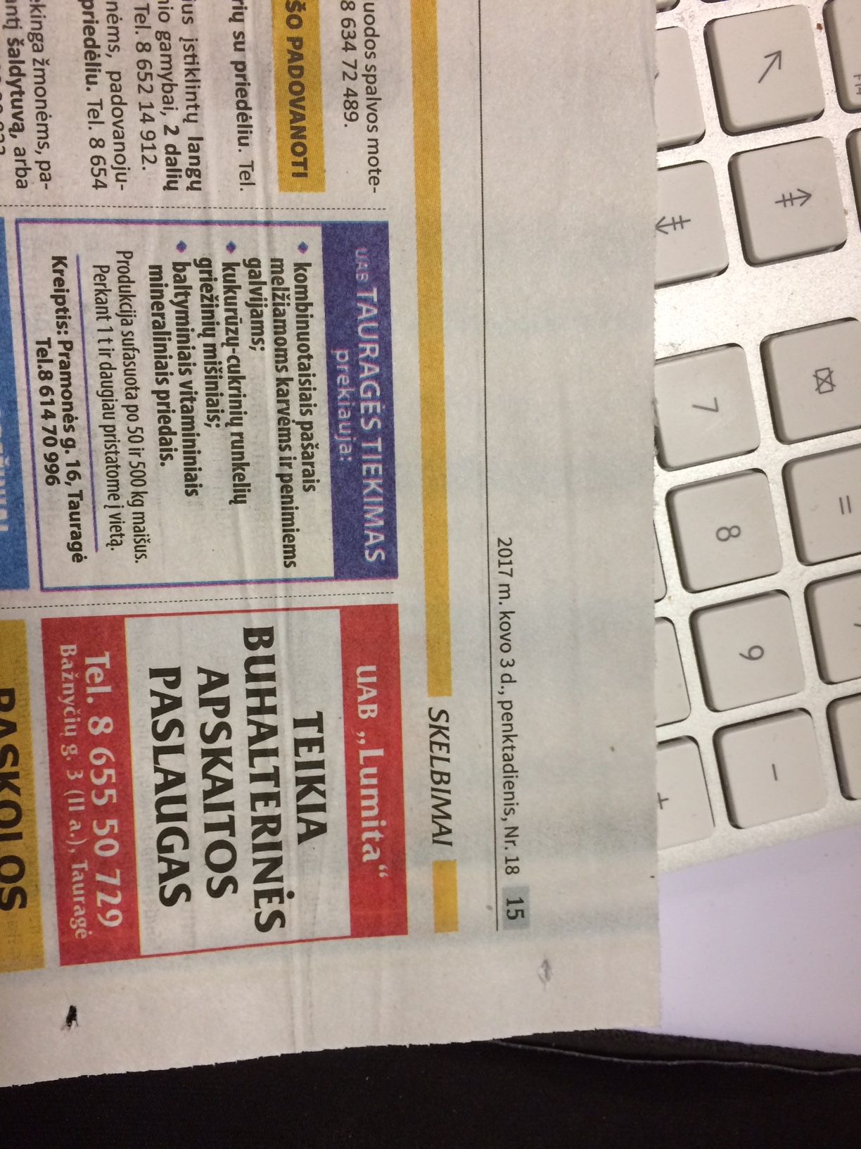

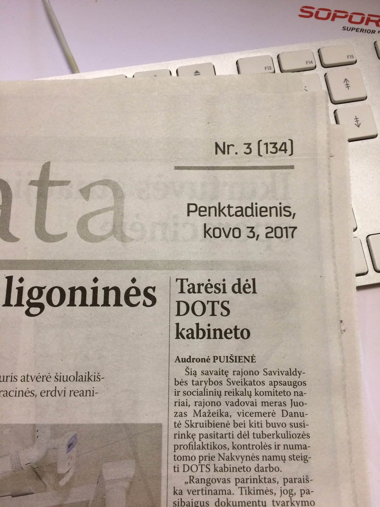

ALL the press cylinders need re-setting also you have "Creasing" of the web.
1) The classic signs that the Cylinders need setting........ look at Picture 4 of the 4 you posted, you will see at the "Pin Edge" a series of 4 or more Cylinder Bounce Marks (Dark)
these marks correspond to the "Cylinder Gears ( Pitch Circle) of the gear teeth.
Regards, Alois

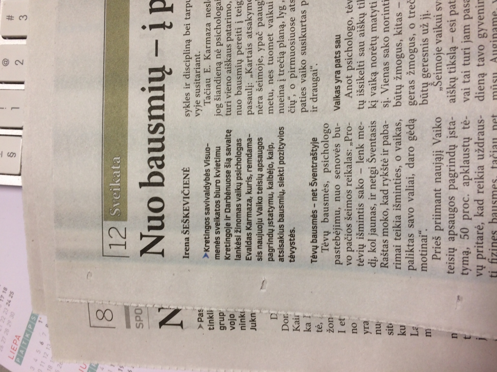

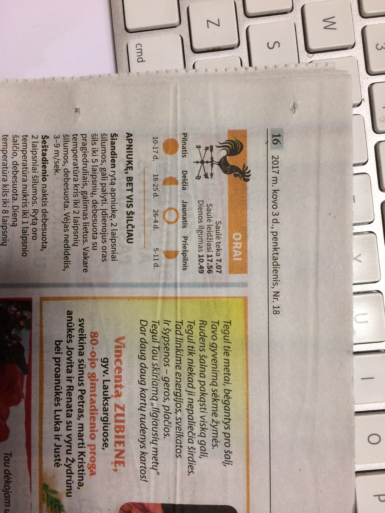

Hi Alois,

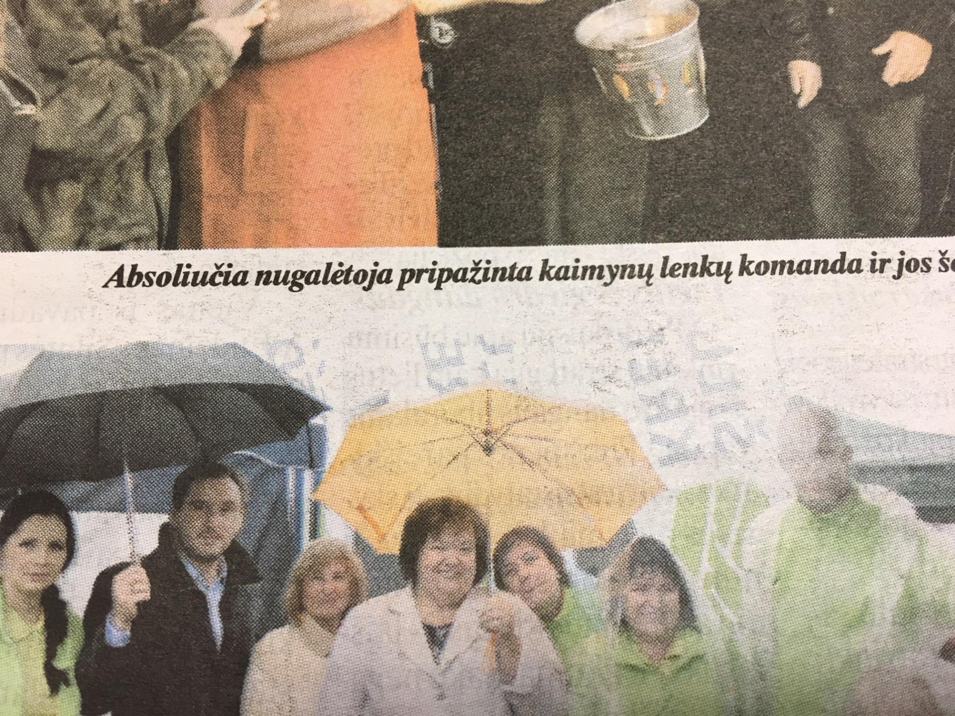

The problems persist, but the rubber has been changed, the dampening is being monitored and everything is better, but the thing which drives a bit crazy is one right now. The printers are blaming the CTP, but I do not think it is the problem. For example, when they have a smaller newspaper of 16 pages and they print 4+1, everything is ok, but when they print the 16 pages 4+4, they use both two towers and there the problem starts - the aligment is gone so far, that it is almost impossible to catch it and the bin is full of kilos of waste.:(( So two towers is a big problem.
What do you think it could be? Not the plates, I do not think so? They are all the same. Or as the paper is getting wider to the top because of the dampening the image on the plate should get a little adjusted and slightly larger by percentage? That could be with the use of an old machine..:((
Thank You Alois!

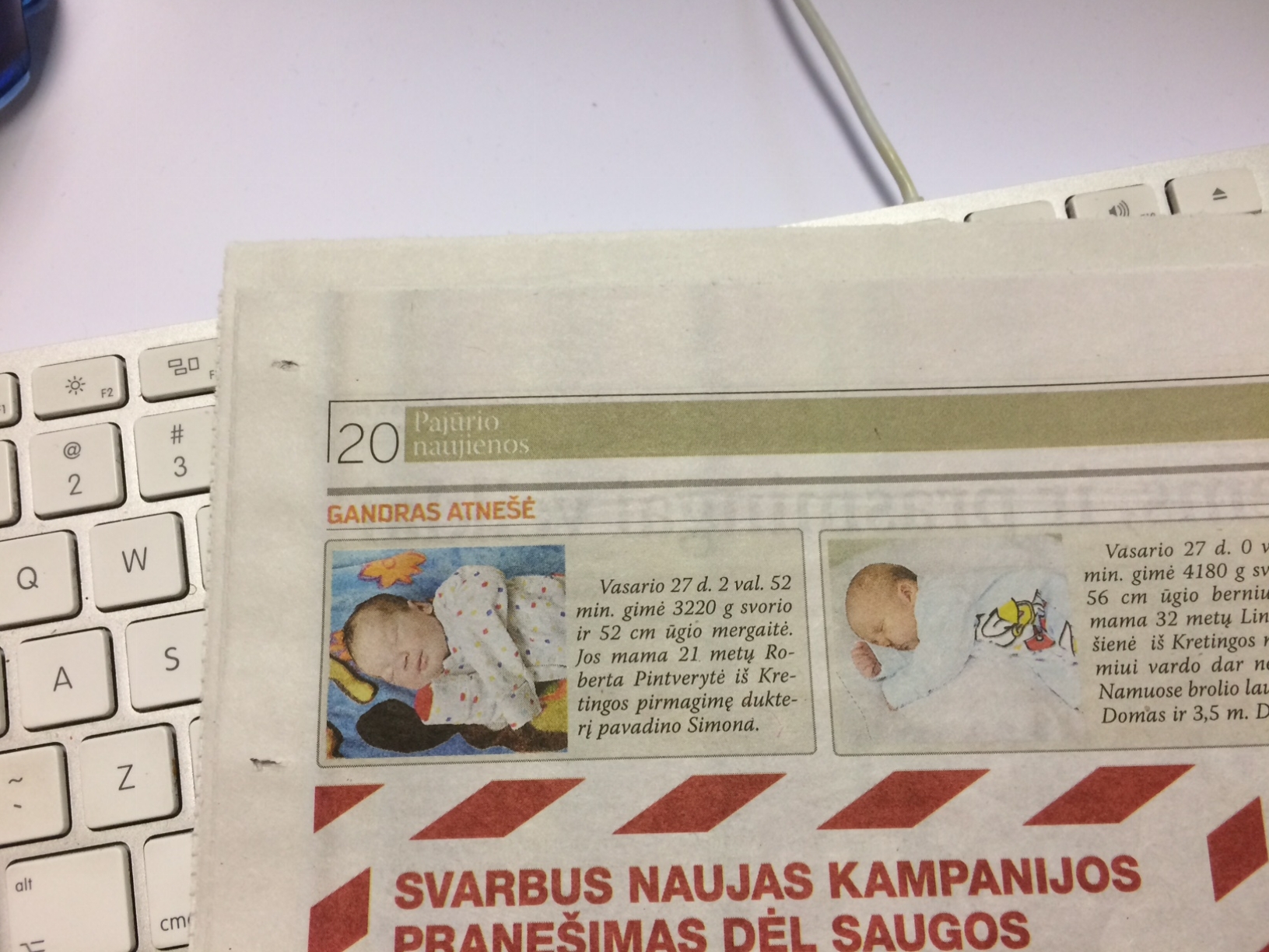

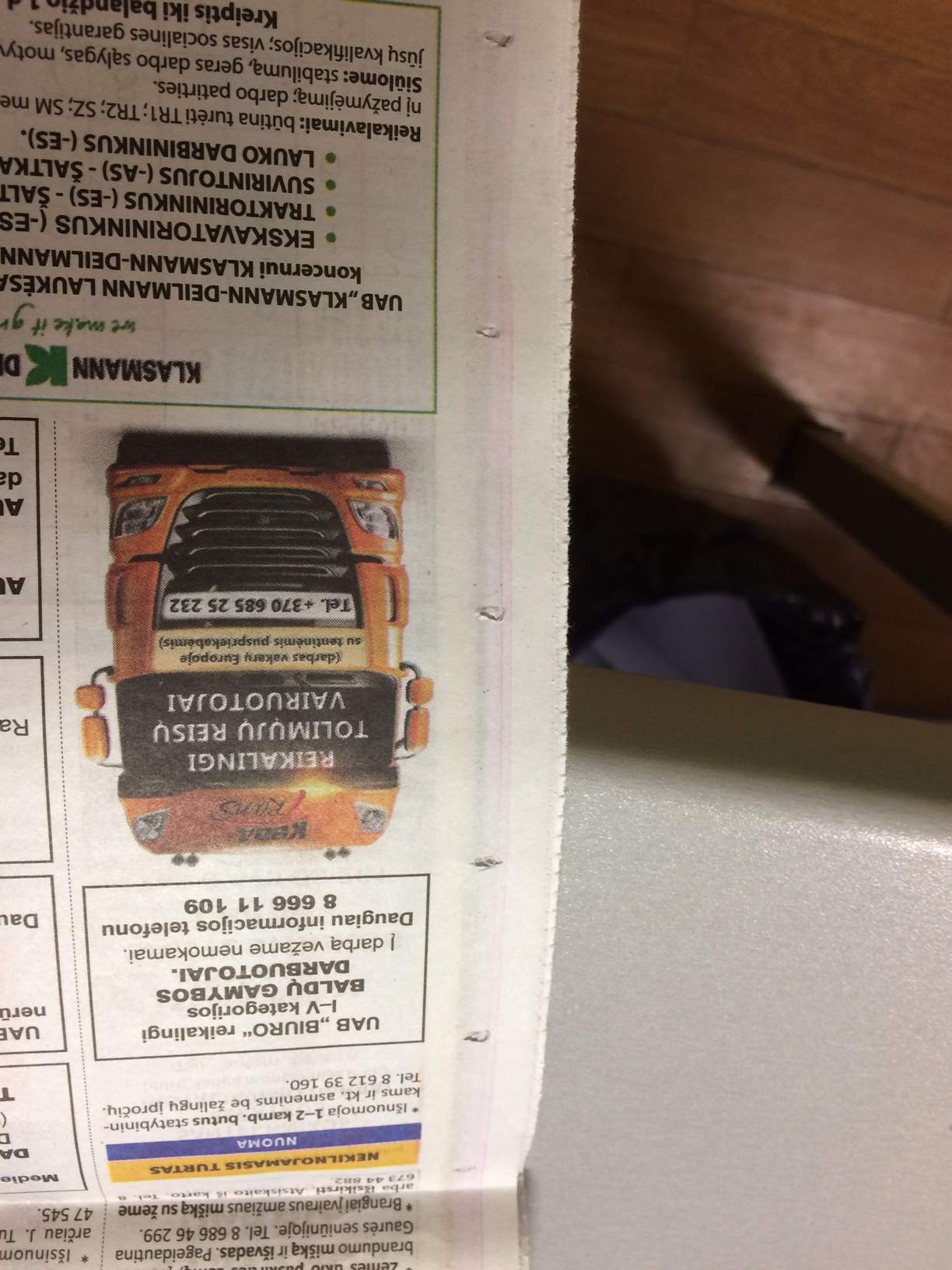

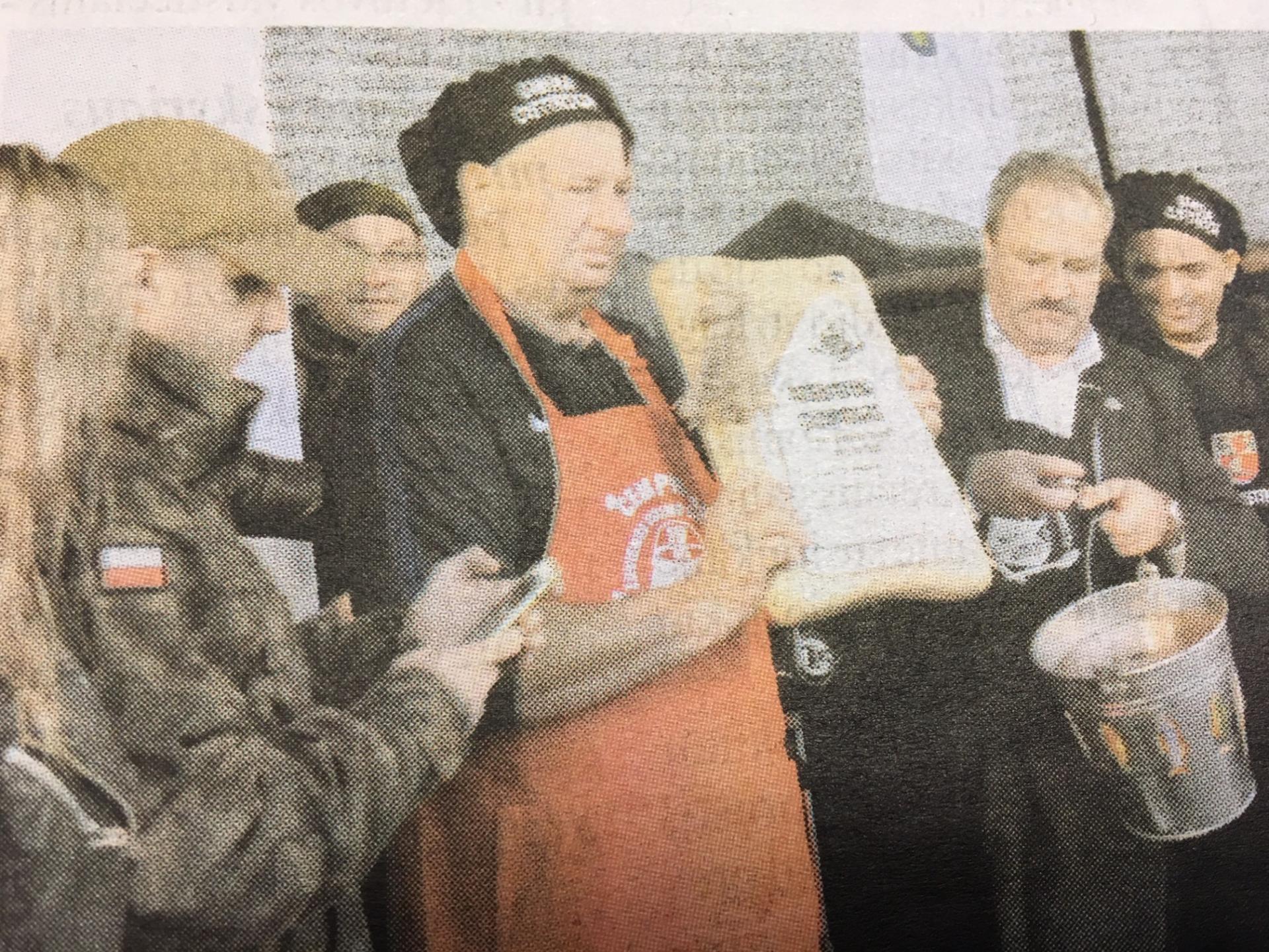

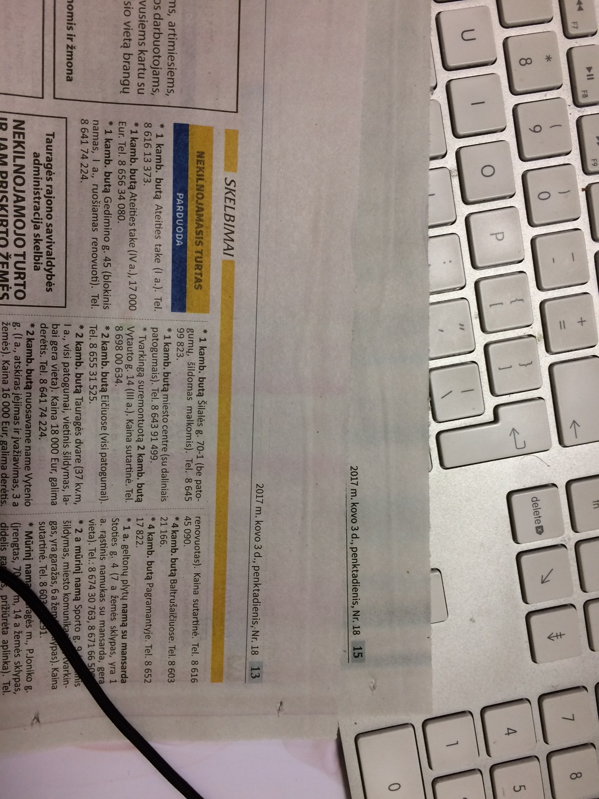

it is a real tragedy:((( one of the newspapers seems to be ok, the other one is a tragedy: pictures are quite ok, just there is a slight problem with the resolution, which is fixable.
there is way too much black, but anyway, we do not get any print quality. mud, darkness. i call it "soup". rubber has been changed. paper has been changed. do the towers (dev&goss, build year round 87) belong to metal waste? it seems the printers cannot print with both towers, or the towers are too old for working with them.
need some ideas, as I am still desperate:(((

Looks good. Ship it. LOL
To get the best results you need to look at your whole system not just one part.
Let's start with the source.
Can you post the original photos of the 1st and 3rd images (the guy holding the paper and the guy with the ladle).
Then post the same images after going through your RIP - i.e. the same images that will be plated.
