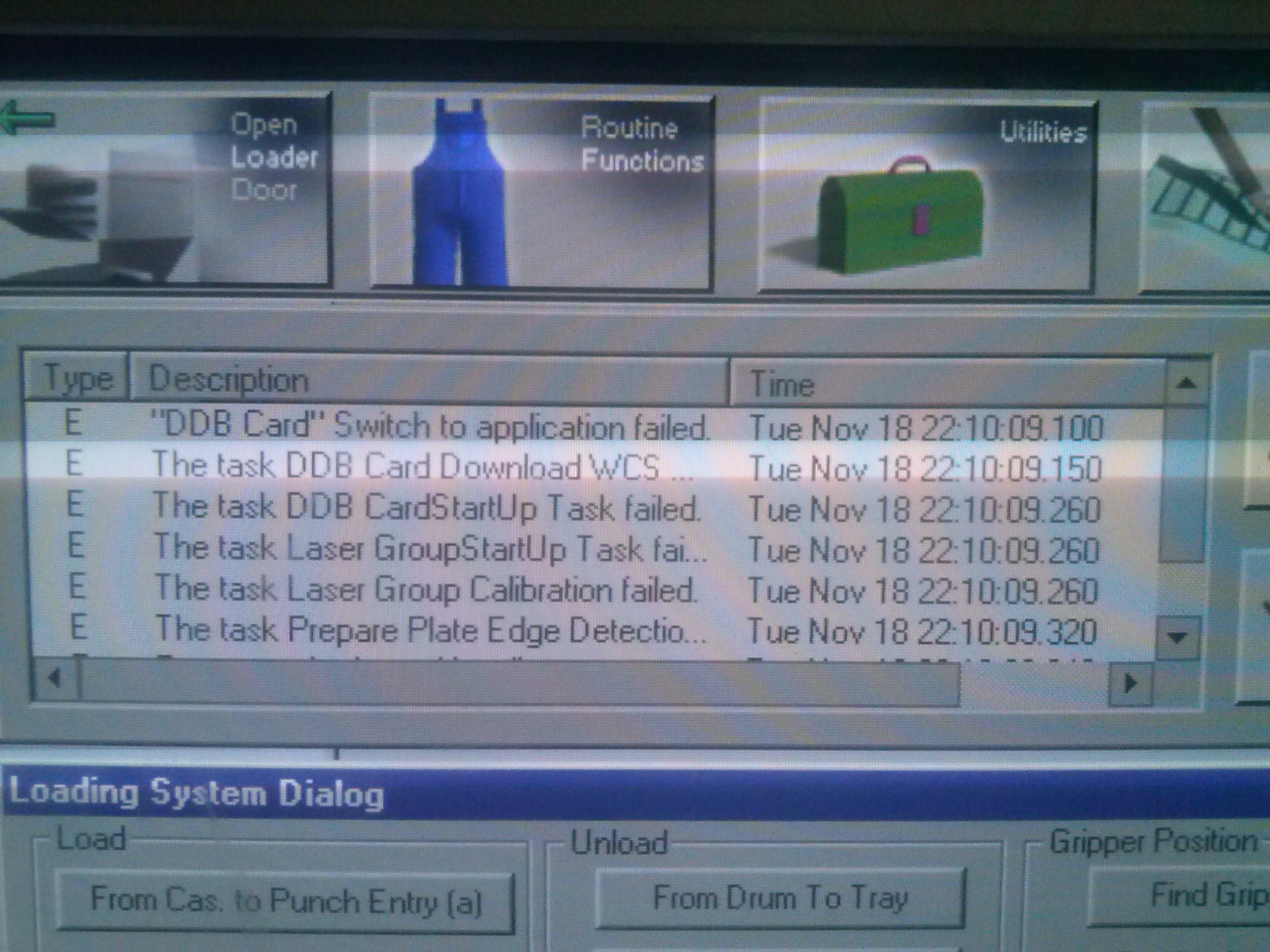

hey guys i've bought a used Lotem 400 from one and it was working nicely
but after i moved it to my place and re attached everything back together ,
a message start to appear everytime i send something to expose
picture attached
opened DDB window on lotem software
but while loading the windows keeps giving me the same message
Check if the breaker switch on the laser box is in the up position. Otherwise you might have to force a download of the wcs by turning the flag on in the registry. If all fail you may need another DDB1N board.
