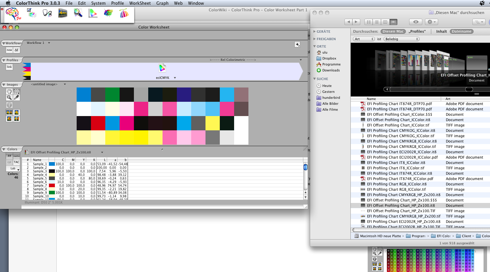

it might be possible (depends on the creator of the profile, is there a look up table or not inside...) with chromix color think, a much more less expensive tool as the big ones like print open or others. (Nearby a recommended and good investment in future if you want to know something about, compare or just investigate icc profiles ...)
There in you have to create a worksheet with the profile and you need a chart-file (as a picture), ideally the printer profile is made with, but others are working too...
then colorthink shows you a table with all patches in the chartfile and you can save it as a textfile
If you will send me via PM the profile and a chart i can try it for you

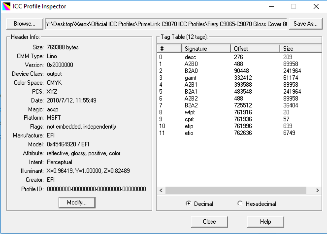

got it now: as well as in the old profile inspector on windows as in the colorsync-tool on a mac the signature "targ" shows the LUT´s, but not every icc-profile has such a signature (e.g. some Munken-profiles...)
