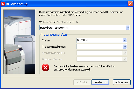

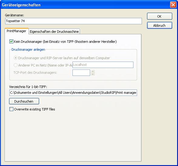

Thanks Martin for the info. Yes I have the print manager . I found a second hand studio rip version 3.9. would this work ?
Hi Vance,
yes it would work. You can install the Topsetter as a Screen PT-R 4300E but without using the StudioRIPs own PrintManager. Then StudioRIP just produces 1bit Tiff files in a location of your choice. This location must be the one where your print manager can grab the Tiffs for the Topsetter.
I hope this helps you.
Hi Vance,
I have to correct myself, you can install your platesetter as a Topsetter 74. that´s better.
Here are screenshots attached for better understanding.
