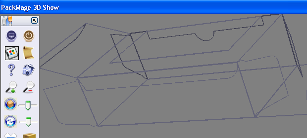

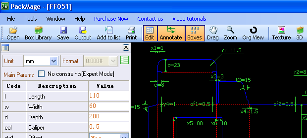

Packmage packaging design software
can someone please share what softwares are used to create die lines for flexo and offset...
Actually I'm testing Packmage currently, it has box and die line predefined in its library, mainly for corrugated and folding cartons, it might be what you are looking for.
we've been using illustrator to create the die lines, but we need something more fancy to show package creases, folds, flaps, etc...
Well we are using a illustrator plugin called toolkit for boxes from Esko. Works great for us. We can turn any structural design file (not created in house) quickly in to a 3D file. Showing all folds flaps etc... I think esko even has a trial version available on the website...
I used artios cad before, it's only free for a month, I can't afford that huge fee buy the license. So I choosed Packmage packaging design software.
i think you are looking for this kind of packaging design software, if it is right please give me a private message, i will give you the download full version.
