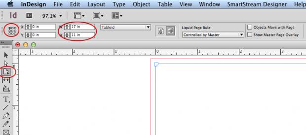

One way to accomplish this is to first duplicate each spread by dragging its icon in the Pages palette to the "New Page" icon at the bottom of the palette. Then you can use the Page Tool to select the first page and change its size to 8.5x11 (this is different than changing it in Document Setup. You can even set which side of the page you want to anchor to. This is important, because if you were to change the page size in Document Setup it always adds or subtracts to all sides evenly). The you do the same thing to the other pages, paying attention to which side you anchor to.
Admittedly, this is less straightforward than your Quark solution, but it works.
I never knew about this. I may try it next time I'm faced with this situation. I had been importing the spreads into a 8.5x11 doc and closing the box to the desired size, then exporting the PDF. Down and dirty but it worked.
