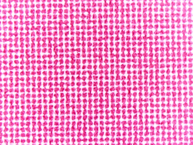

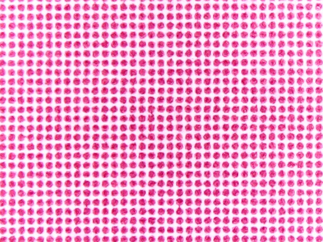

Preface (short). Recently we've bought an usb-microscope and found out that our printed dot is very distorted. We're just cryed out – whohaa, that's the key to our unstable dot gain problem.
Some time later we're made a big test using different founts/blankets/inks combinations (not so big, really, just what our supplier was able to supplied us with).
Printer – sheetfed manRoland 705 LV, exellent mechanical condition approved by serviceman. Tests were made in absolutely same condition (even same pressman). The only differece – ink/fount/blanket. Linear forms, real round dot, 200 lpi
So here two pictures. What we've start with:
And the best result for today:
So, the question(s) which bothers me: is this result is good enough? And how bad was what we're start with?

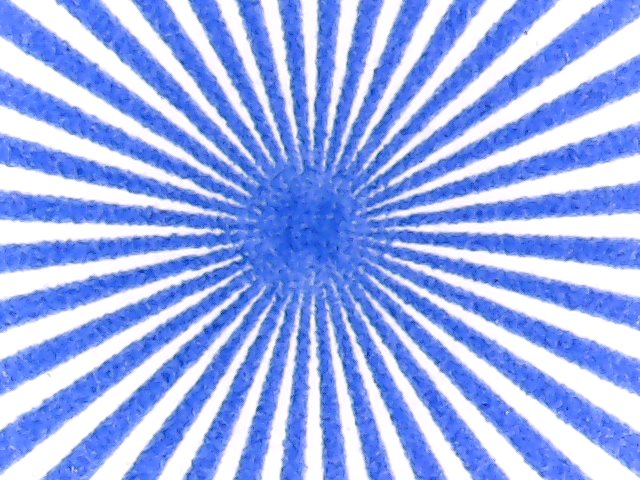

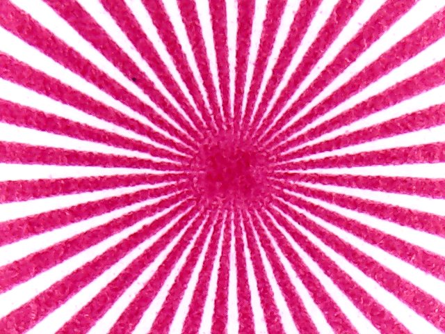

Cementary,
Halftone Dot Fidelity result (A) Awful !
(B) Not much better !
You are Printing Snowflaky Dots !
Try and obtain LTF Star Target and print a series of them with a Print Control Strip
Regards, Alois

Cementary,
A quick check of the Plate Dampening Level...... YOU should see a thin 1 or 2 mm wide - Even Scum Line on the Lead Edge/Bend of the Plate
across the plate width.
Regards, Alois

Yep, we see it at every press /every section. Every print for test were made from scum level, e.g. water down to scumming appears – then 1-2 percent on ductor up.
Cementary,
Regards, Alois
Alois, do you have images with good, not so "snoflaky dots", 200 lpi? Maybe anyone else have?
I agree that (A) is awful, but i see difference between (A) and (B). There is a 10% difference in dot gain (50% patch) so i'm confused – i thought that was a lot better.
