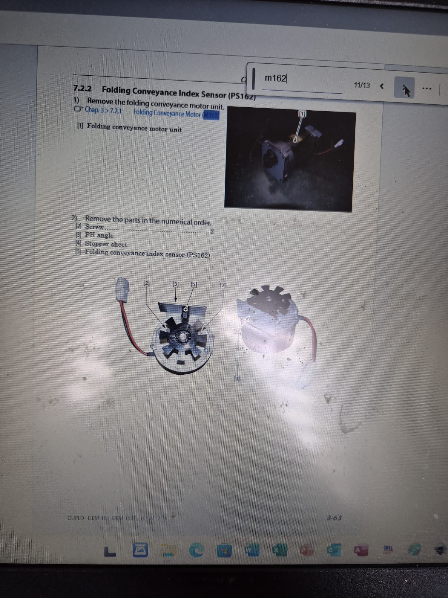

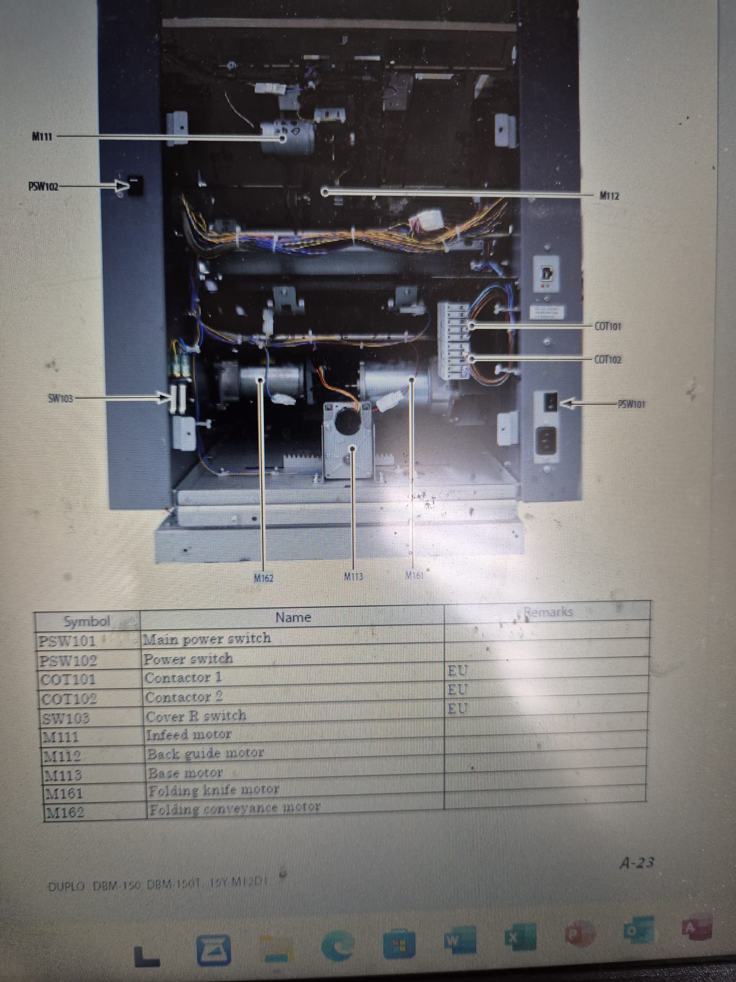

Hello, anyone know how to resolve an error code E800 - Motor Error Eject Lock on a Duplo DBM 150 bookletmaker.
Hi. I had the same thing. The sensors need to be cleaned. Ideally, blow out with a compressor. Specifically, the sensor on the M162 engines.
