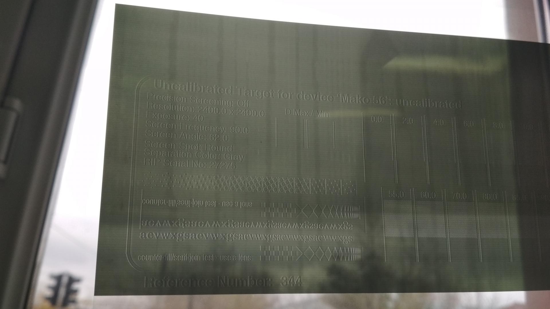

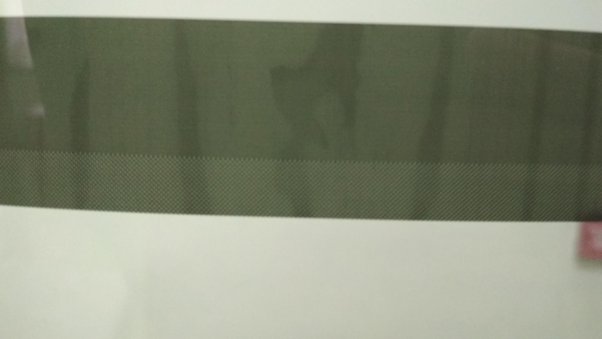

We had a problem with MAKO 56 - he began to display the film all black. With a low exposure of 20-40 and the conclusion of the test pattern from the RIP, it can be seen very poorly, as if in a negative. In the chief photo you can see it. Let me know if there are remedies, suggestions...

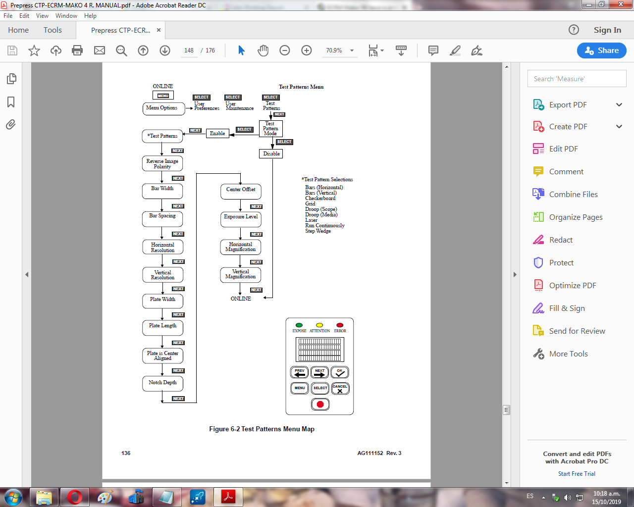

You must go to Enter or exit the menu sub-system by pressing MENU from the ONLINE or the
OFFLINE state.
Control Panel Keypad
The platesetter provides a series of menus to set up various parameters. The control panel keypad is used
to navigate through the menus and change parameters.
Attached the guide.
Blessing.

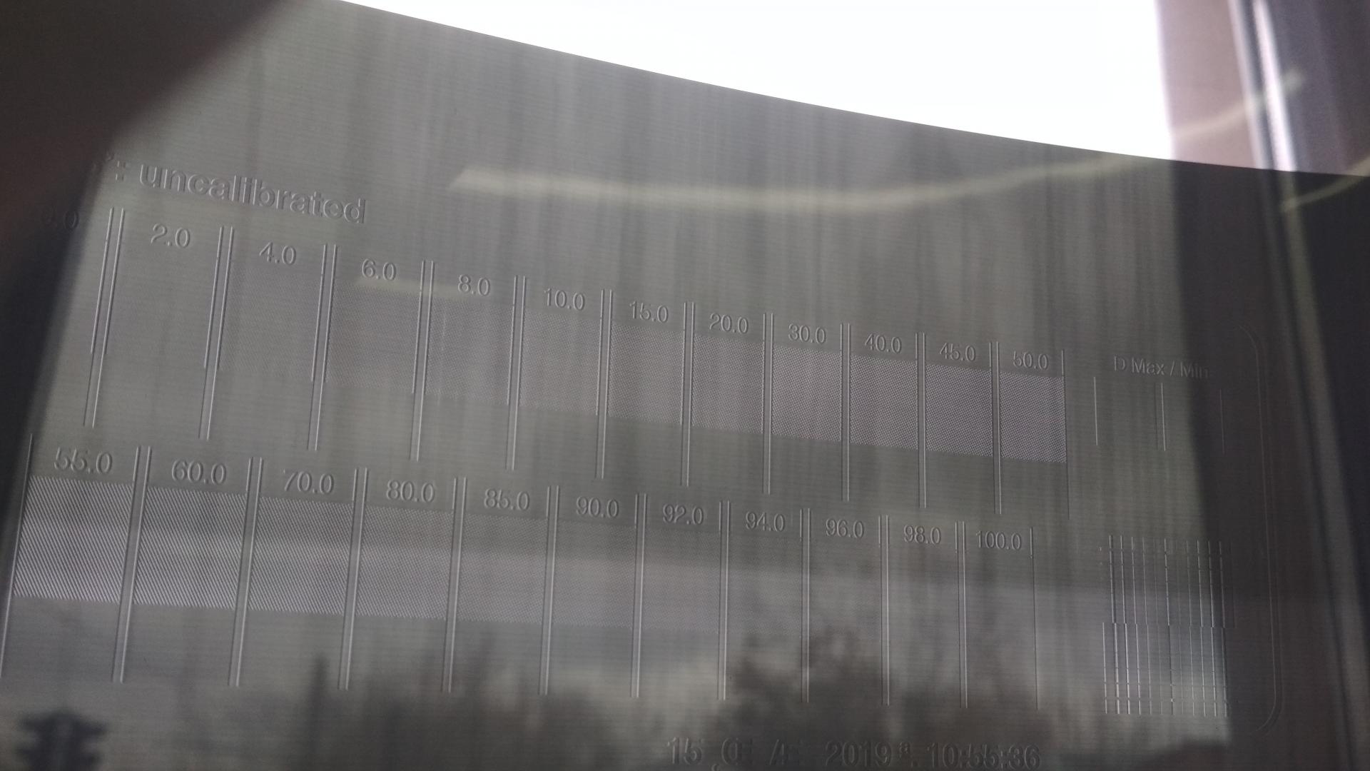

Thank you for the instruction, but it is not CTP that is faulty with us, but the MACO 56 ECM. I found instructions on the Internet for launching Test patterns, the test is visible but the black background still remains.

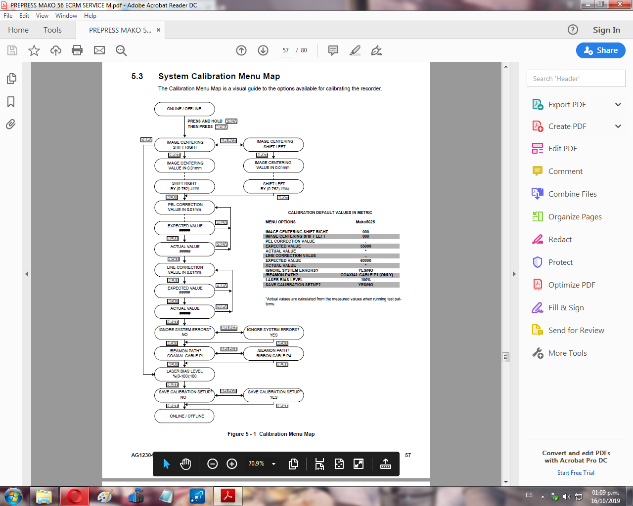

Sorry sir:
Attached is there block for calibrationo for MACO 56, Hope you can fix it.
However let me know, any question
Blessing.

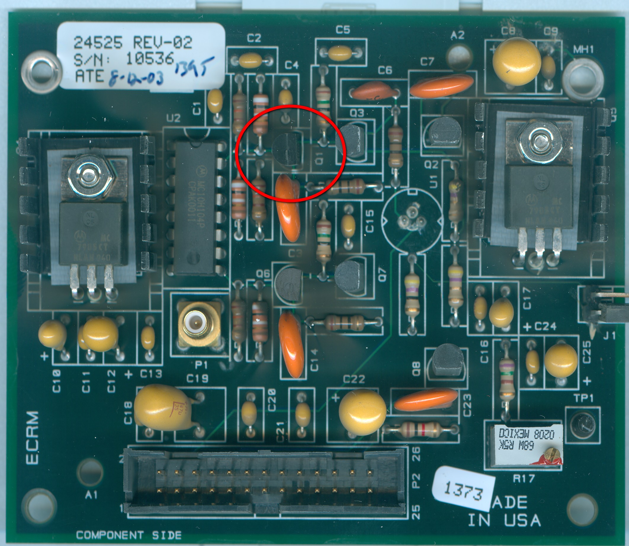

Just now I came across letters from the forum in the mail, and decided to share my experience. Everything ended well: a simple transistor on the board near the laser failed. Replaced and has been working normally for 2 years. I attached a picture showing the transistor.
