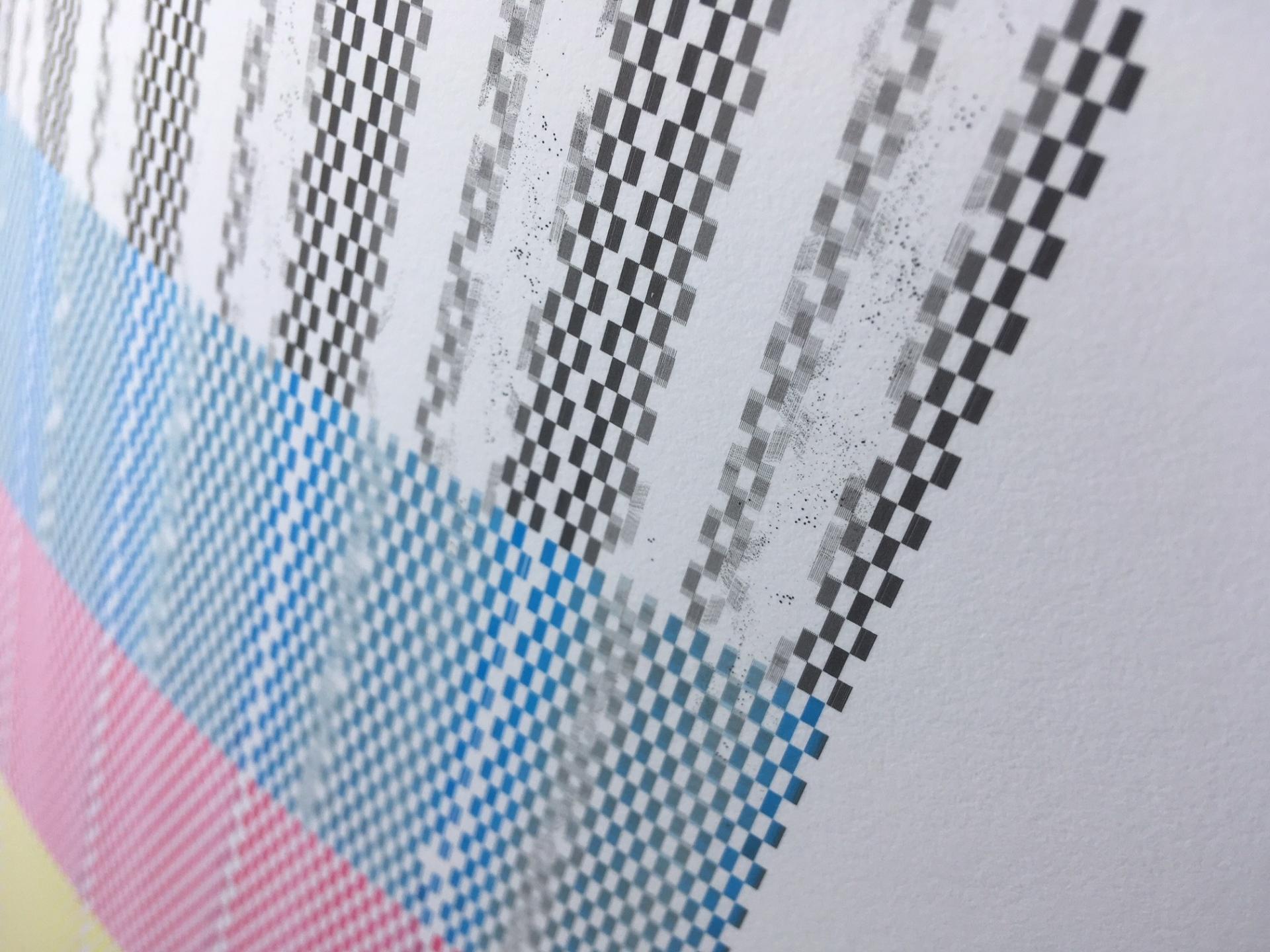

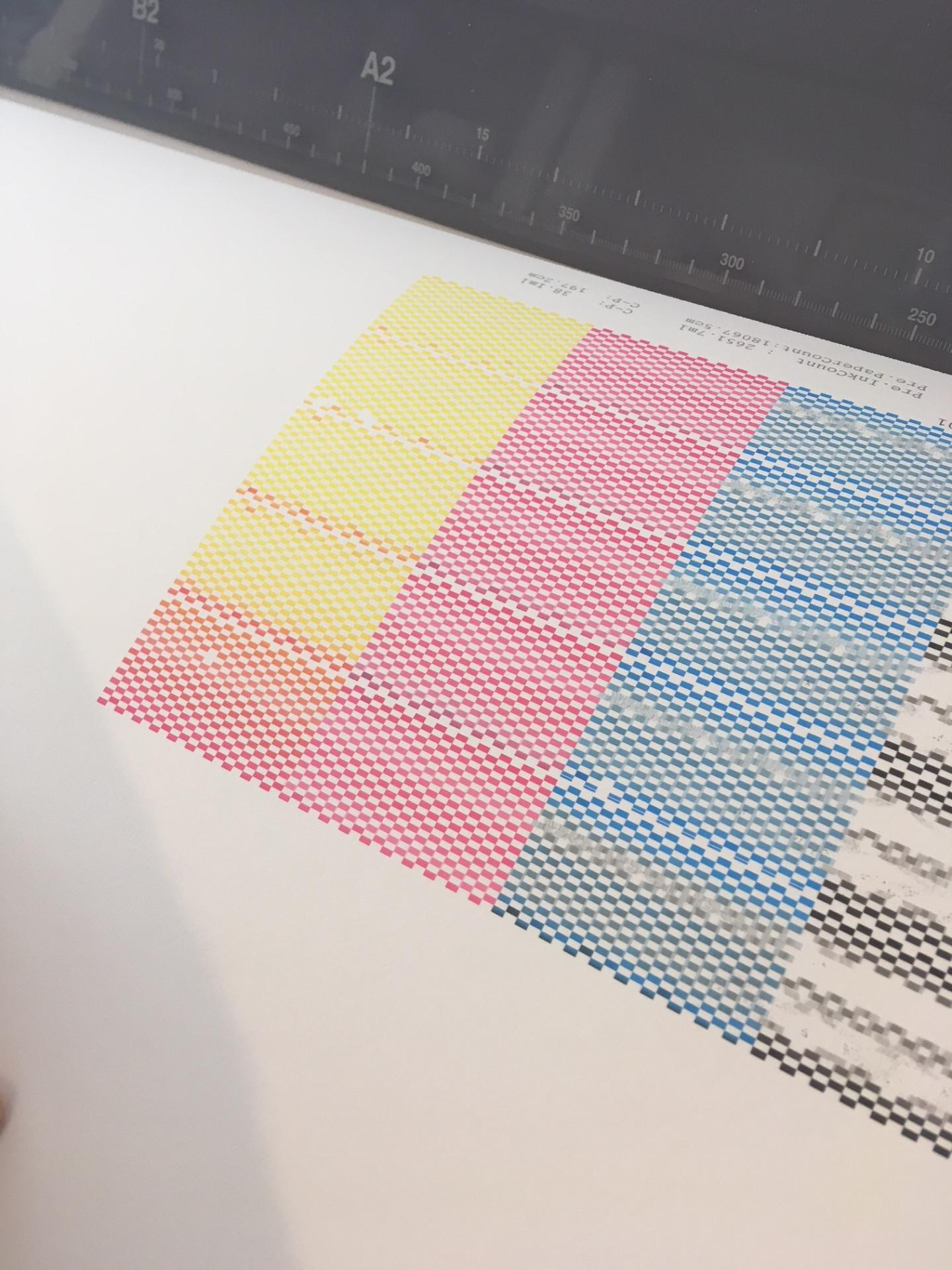

Hi all,
Bit of a long shot - but just wondering if anyone has experienced a similar issue with an epson 7800 (or like). I have performed the usual nozzle check and power clean, and even some manual cleaning following advice of several youtube videos (cleaning wiper blade/spit pad) but still no change. It does still print quite well but certain colours are affected and darker colours quite insipid/pale looking. Might be an inoperable print-head issue but I'm just exploring all options to avoid scrapping! Any advice appreciated! Thanks.
Graham
UK
gsbatch
I had to make a cleaner file with solid bands of CMYK and printed on our heaviest vellum until the heads came back to life. If that doesn't work look online for a piezo flush kit.
