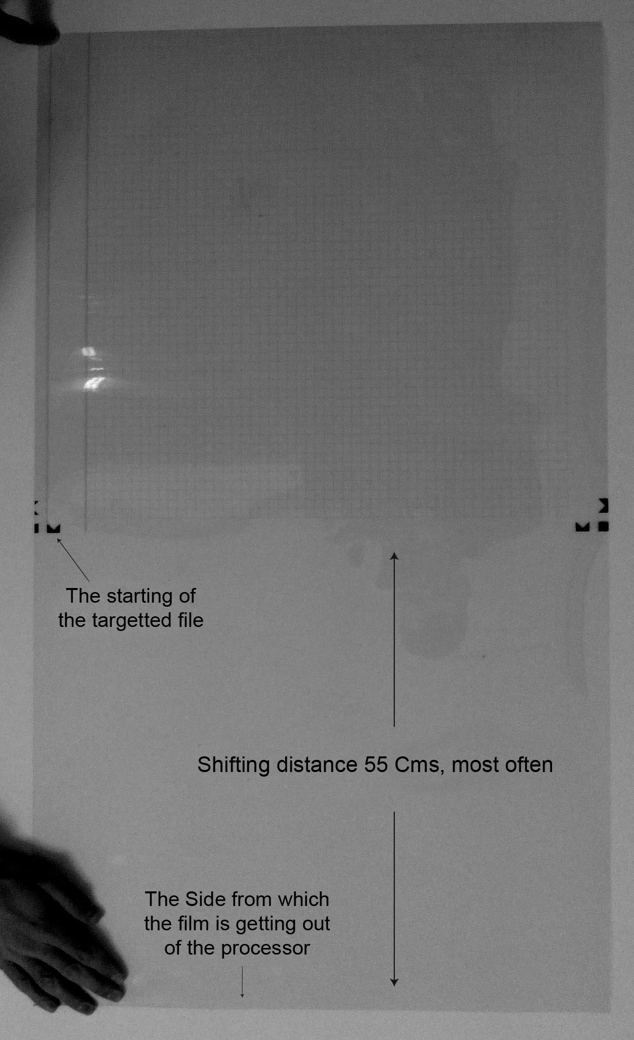

The starting point of printing is not stable…….usually it starts 55 Cm ahead although it cuts the film accurately (for example, 70-100 exactly when asked to do so) ……sometimes the unpleasant shifting becomes the opposite in which it starts printing after leaving 8 cm blank ……Thanks
After trying a huge number in the " measured offest " input the starting point of printing became good and a complete file of 106 * 70 was successfully printed. However, the instability is still a problem in which three or four films are ruined in every 10 ones printed. There is not certain constant pattern for the mistaken films; for example, It was once recorded as follows: 2 films shifted "55" cms , three ones good, one shifted, four ones good, two ones shifted.
