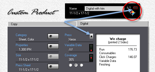

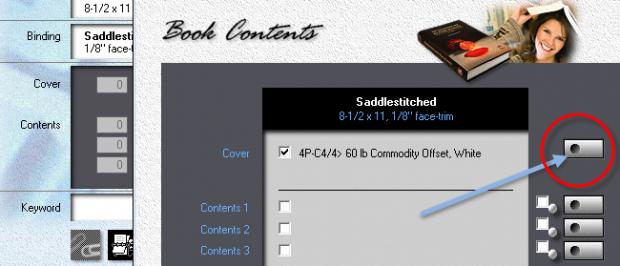

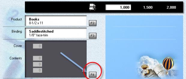

Once you've entered the booklet type and size, click or press F4 to select the contents, DYP. The screen captures illustrate how to enter the cover. The same workflow applies to the inside signatures.

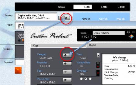

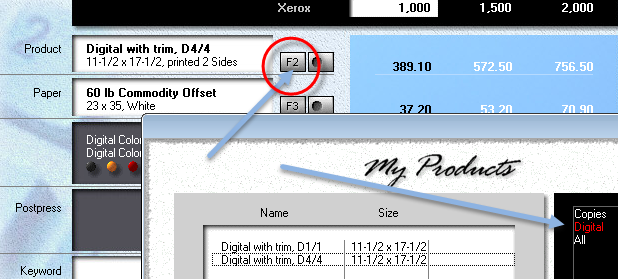

When the product entry window opens, click or press F2, then select either a copy or digital product from the picklist. To customize, click the button to the right of F2 (or press Ctrl-F2). Select color for the front, then click the small button in the upper right to rotate through 4/4, 4/1, or 4/0. That's all there is to it. The only reason to select from the picklist first is to avoid having to enter a bunch of unnecessary stuff when you customize - the custom product inherits the properties from the product in the picklist. Morning Flight - V14.1
Note that you can mix and match between copies and digital, and color or black, for the cover and inside signatures. You can even add a reply card or an envelope as an insert. The workflow I described for the contents is identical to how you enter a digital product: Morning Flight - V14.1

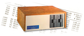

One of the most difficult positions a software developer can be placed in is smack in the middle of the Mac/Win religious wars. One of the dumbest things to do is to then pick sides. Experience has taught me that I shouldn't do that. Declared my neutrality in February of 1984 when I bought a 128 Mac to replace the pre-Windows/pre-DOS 1978 Northstar Horizon I had ordered as a kit, then wired together inside a wooden box.
