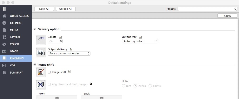

What do you mean you can't change the defaults?
I stand corrected!! Thanks DYP...I think this was something I was told you couldn't do on CWS 5...but I checked one of my other PC's which has CWS 6 and see this option which you presented.
I think you could do it in CWS 5. The default setting was just in a strange place like under Color Management.
