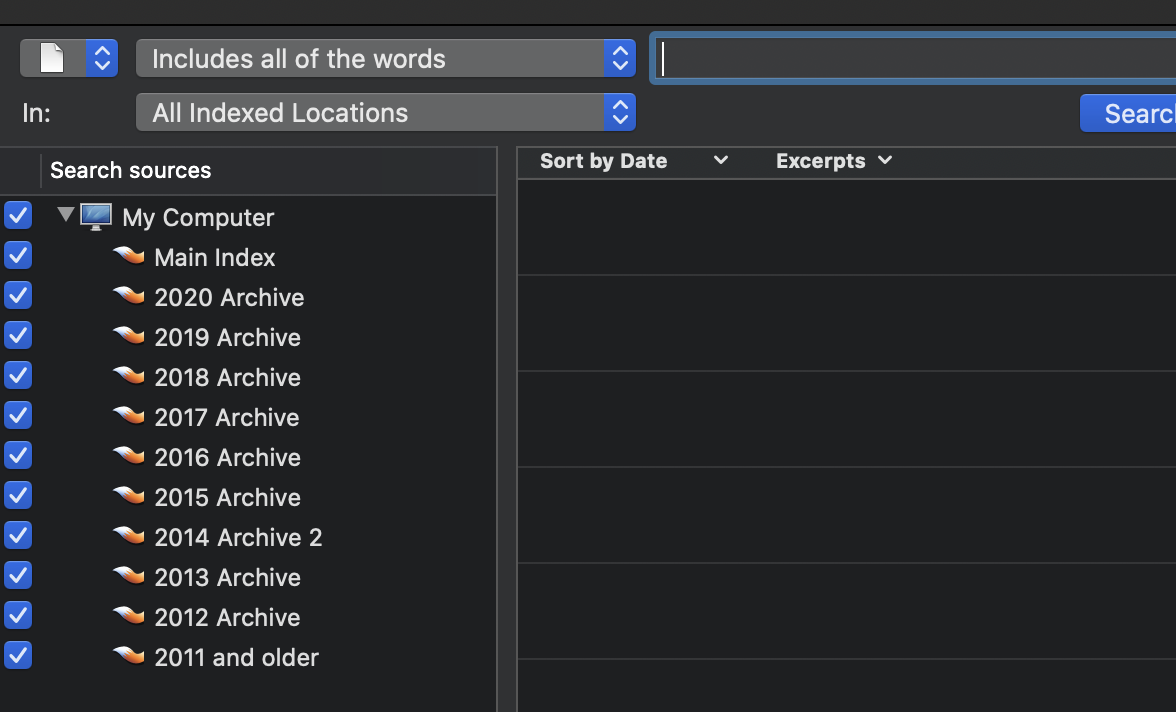

I use two mirrored Drobo 5N's for storing searchable backups in additional to archiving everything on DVD. This is their current version of the NAS system: Drobo 5N2 I have ours setup up with max sized HDD's and a max sized SSD for caching.
Then for searching I use a little program called Fox Trot: Fox Trot Pro
It keeps a searchable database on the local machine with direct links to the NAS (or any other network connected machine), so you don't have any of the lag of a searching the files over the network, and you don't have to try to use the randomly functioning Spotlight. (see screenshot) We have our archives by year, and I set up a separate index for each year. That way it's only updating the active index. I also have it set to NOT archive full text and file information the databases get HUGE when you do that (maybe would be better if you were archiving photos) and can be a PIA. The program can get a bit snarky sometimes if it's interrupted when doing a scan, but the latest version has improved a LOT of the glitches.
Finally, we of course have minimum 4TB external drives on each machine for time machine back-ups, and use a small program called Time Machine Editor TME to set it to only back-up once a day so we don't bog the systems down with the constant logging.
I do have to add that we only have three in my department including myself, so we only use the NAS for archiving. One person works on a job start to finish, so we don't do a lot of sharing of live job files, and each tech stores their live jobs on their local machine.
Oops, forgot the image, and it won't let me edit.
