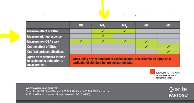

How I control quality when printed fluorescent ink ? I could measure L*a*b* values or density values? Thank you sir
DeltaE
In my opinion, this ink will absorb UV light and emit some visible light. So I recommend you to use spectrophotometer with light source with UV light (like xrite eXact - M1). See picture for your infomation!
Regards,
Delta E
