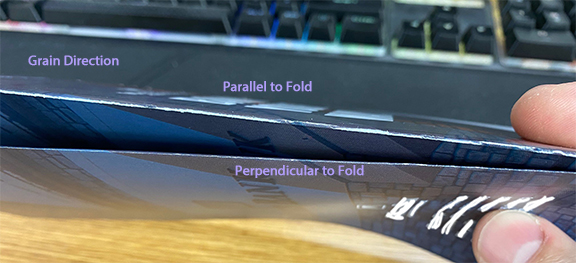

We run about 30% of our volume on 100# Dull Text. If we try to crease and fold parallel to the grain it cracks and even splits sometimes, but if we crease and fold perpendicular to the grain, it looks beautiful.
I was reading a website the other day about grain and it was saying just the opposite and that you should fold WITH the grain.
Can anyone shed any light on this? Unless all the skids we get are mis-marked, I don't understand why this is.

I can't be sure from the photo, but it looks as if the score/crease is on the inside of the fold, it should be on the outside of the fold otherwise you are applying more tension to the paper fibres instead of less. The purpose of a score is to change a 180° fold into two 90° folds to reduce the tension on the fibres and to do this must be on the outside of the fold.
Yes, we ran this on a toner machine. We tried creasing this both sides using creasing matrix on letterpress. We even tried creasing from front and back. That still provided a fold that looked worse than a non-creased fold against the grain.
