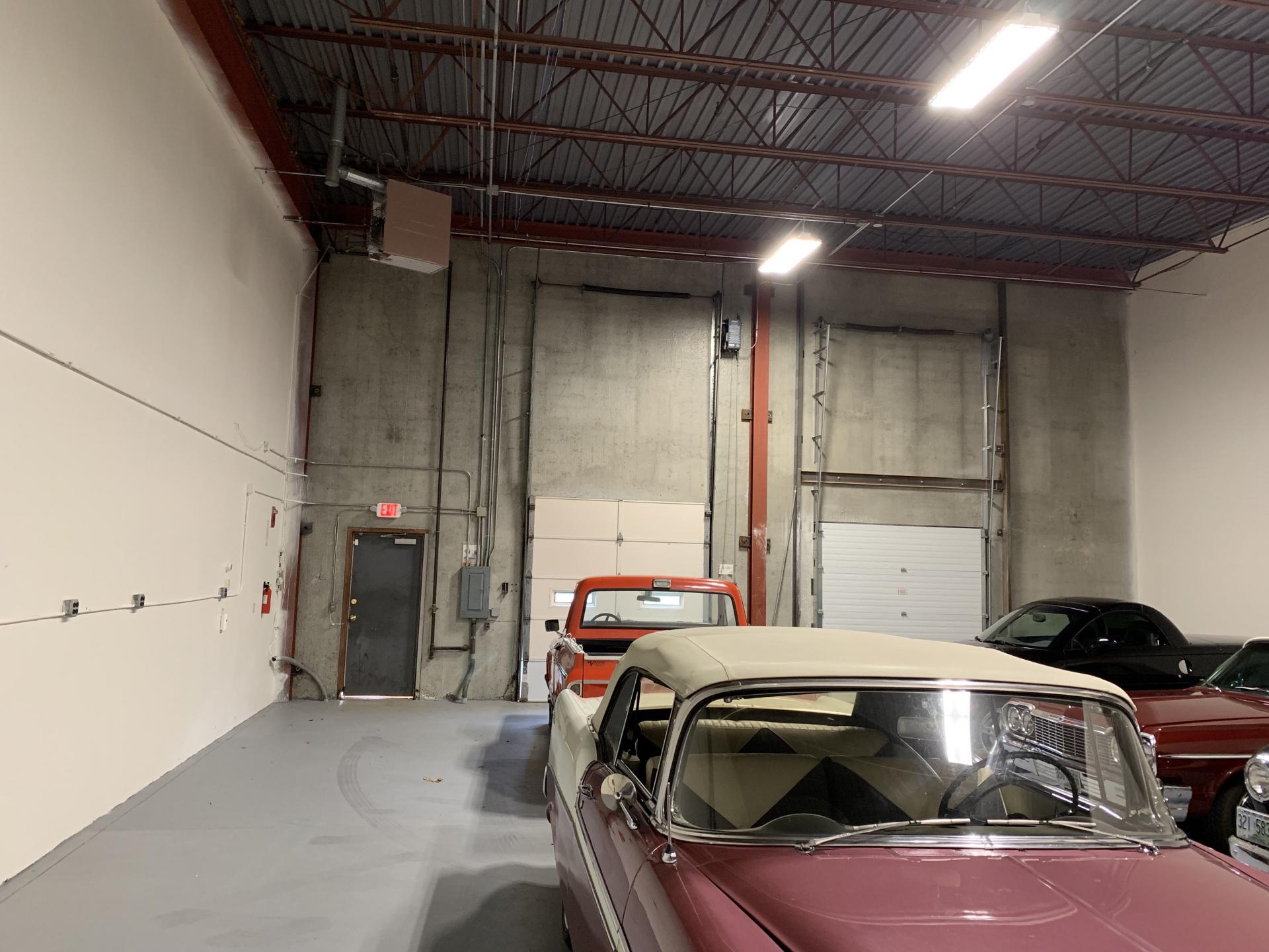

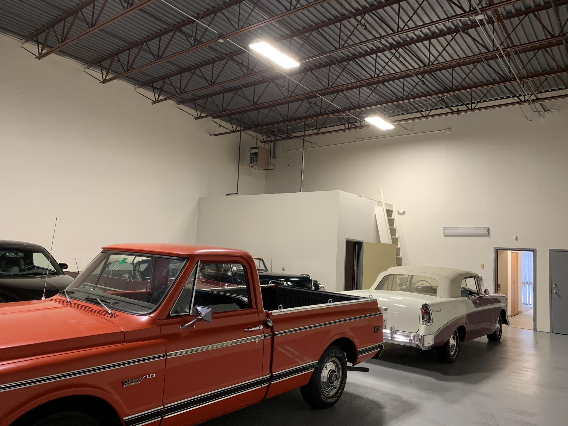

My company is growing out of our current office space and I'm looking at large spaces. I know that temperature/humidity control is important for paper and machines so I wanted to see if people could provide some feedback about having machines and paper material stores and used in a garage (see images attached). I would be running Xerox printers, inserters, stampers, cutters, folders and I would also store all of my paper material.
Is this an acceptable work environment for machines and paper? What kind of things to I have to think about/purchase to ensure the environment is conducive to a mail shop.

They have AC in the office space. I'm finding out if the HVAC system will be large enough for the garage space too. My assumption is that it won't. If not, what type of AC unit do people generally put in a space like this?
Don’t listen to a bunch of printing experts about which HVAC system you should get. I’d suggest consulting with a HVAC guy Who can come out and assess the space.
How extreme are the temperature swings? I know in our non insulated "garage space" right now it is probably 90-95 degrees. Its 75 and sunny outside. Our office is built "within the garage" if that makes sense and is well insulated. Stays high 60's in here with nothing running. Pole style building with metal siding and asphalt roof. It would be a bear if we wanted to add HVAC to garage part as we would need to insulate and finish out first.
I'm not sure about temperature swings in the garage. There is only one side that is exposed to the outside so it shouldn't be too bad. However, I'm in Mass so winter temps can get to 0 degrees and summer temps can get into the 90's.

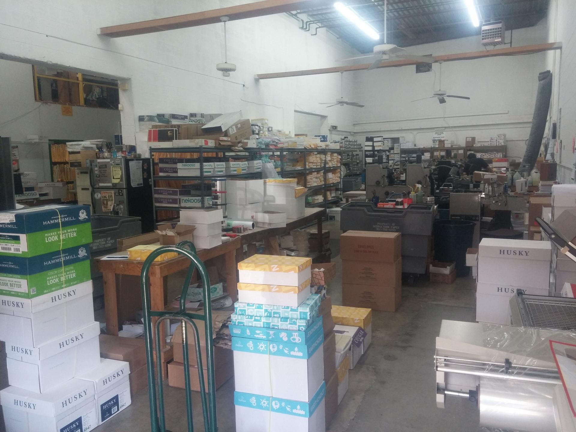

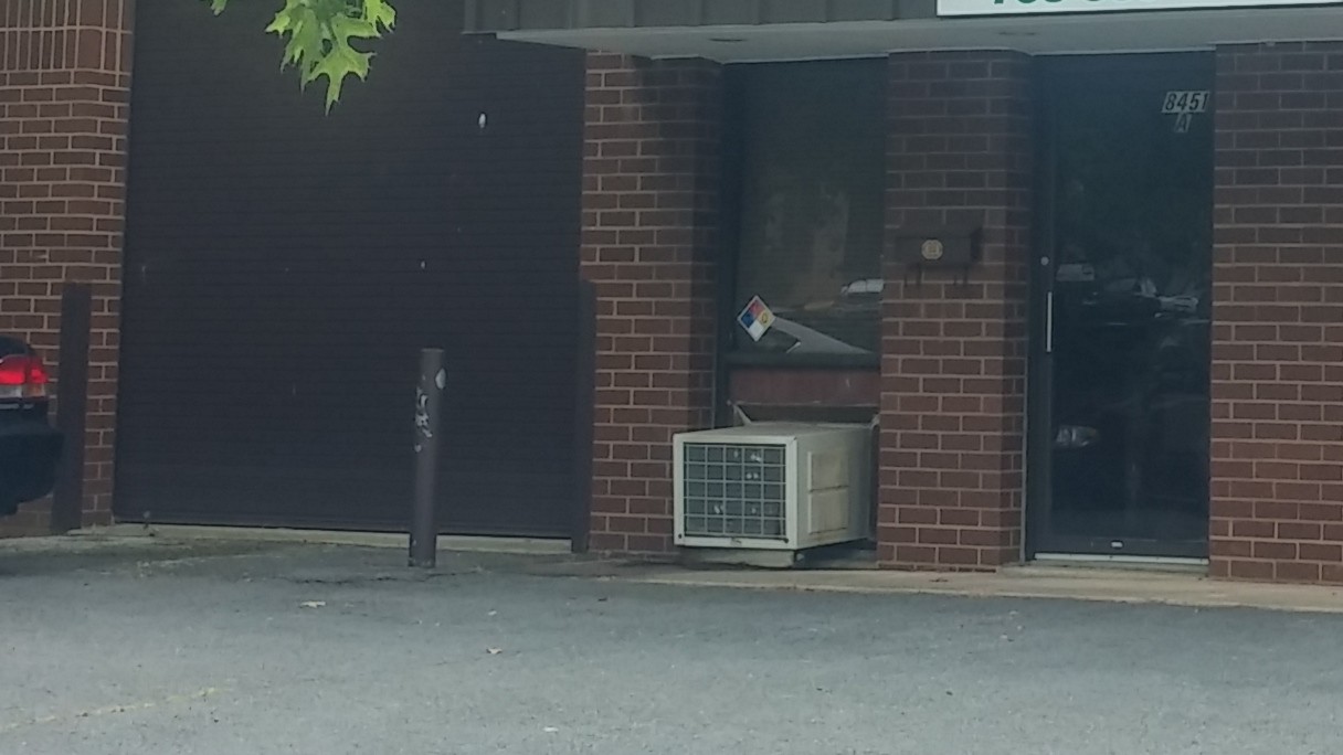

We used a 28,000 BTU through the wall unit and a fan at the other end pointing straight up. It did fine. Northern Virginia. Weather from one extreme to the other. I know you don't have a window or wall you can go through, but it shows that you don't need a huge unit when you are between other units.

gregbatch wow, that's all that you have and you're not having any issues with paper material? That's awesome.
Also, is that through the wall unit just air conditioning? It looks like you have your heating unit near the ceiling.
Yes. Just AC. Reznor gas heater at the ceiling. Looks like you have 2 in the bay in your photos.
Find a Goodman dealer. A 3 ton split system costs about $2k plus duct and install. Figure about $5k total. The hole in the roof for lines and electric is much smaller than the hole for the heater flue you have. They will hang the air handler from the trusses, most likely near the bathroom for the drain, and run a straight duct with a few air diffusers
