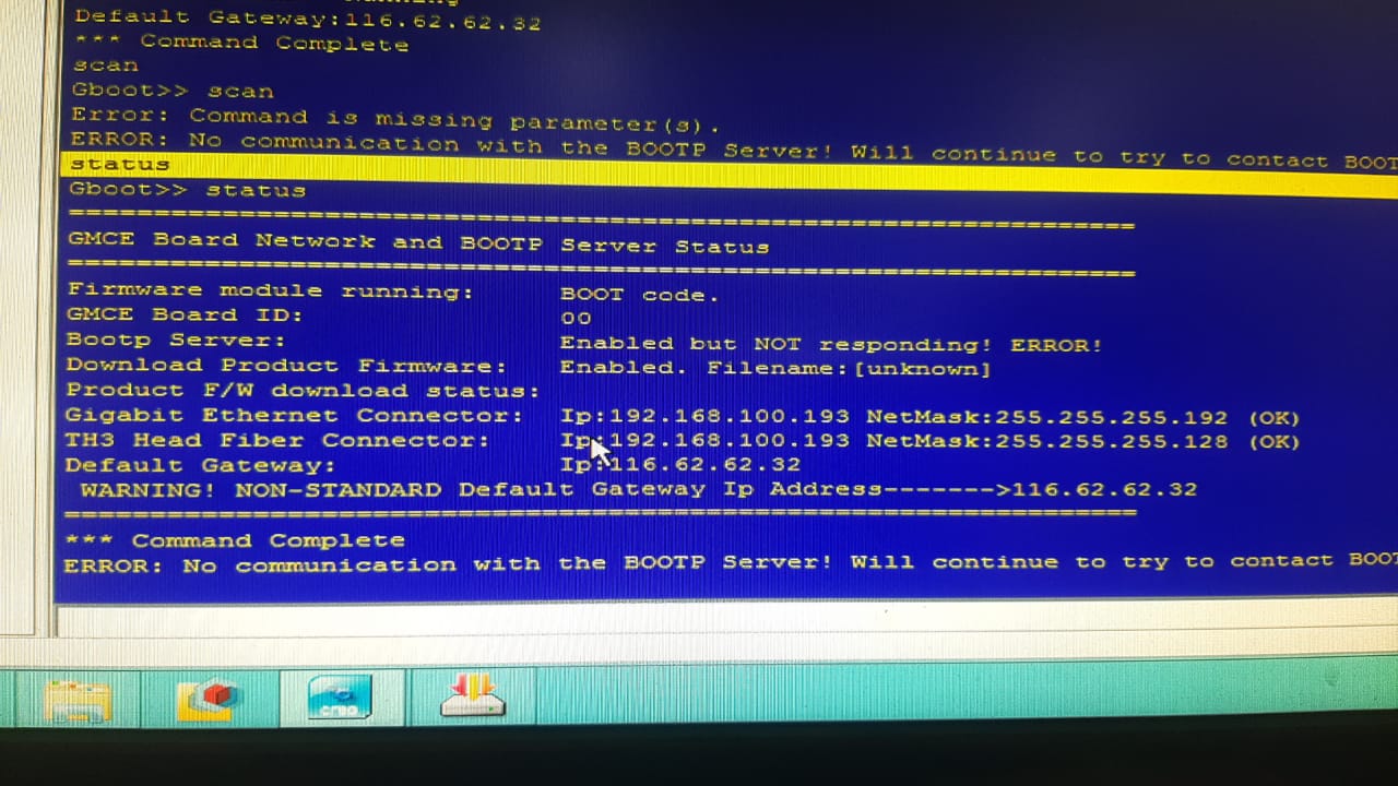

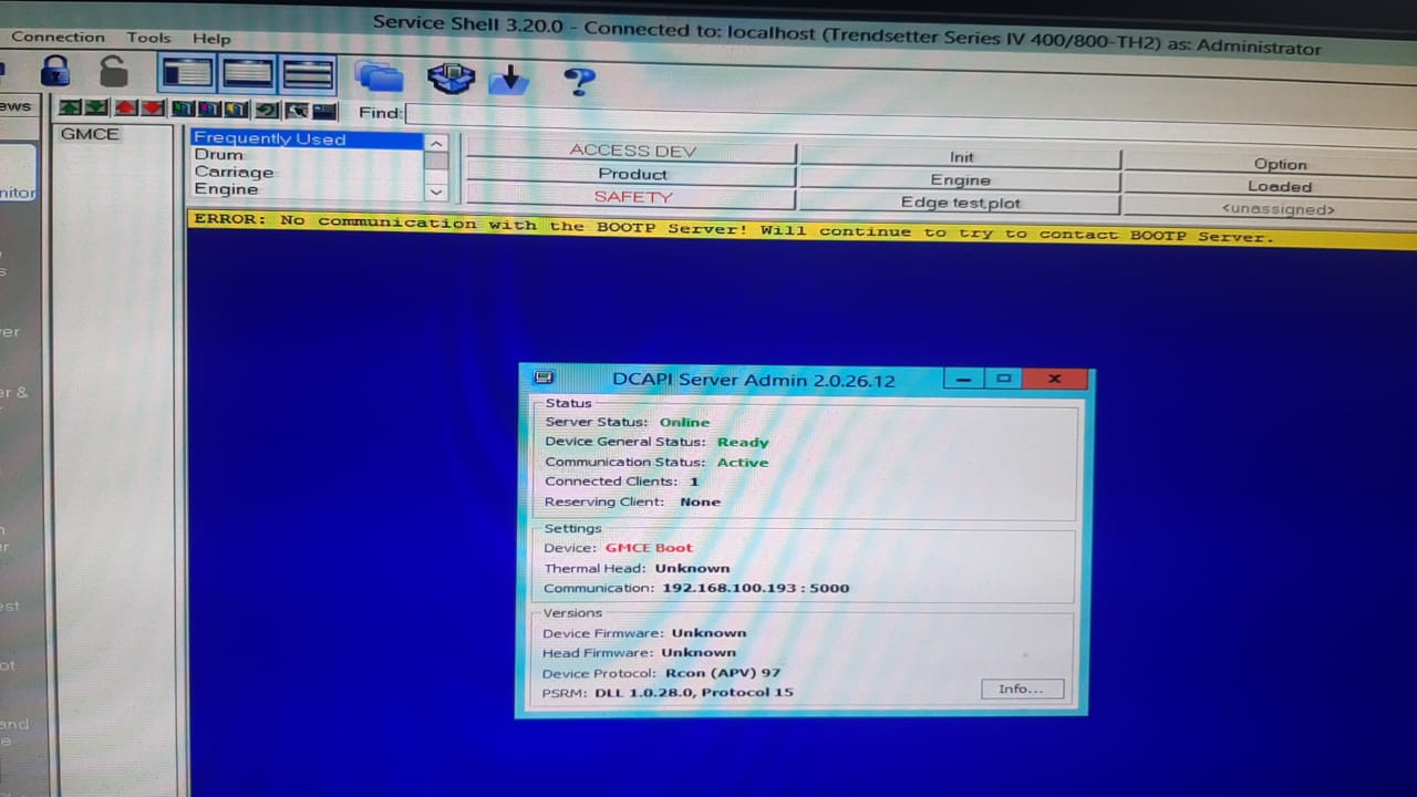

Hi,
There is error while booting Trendsetter 800 IV. service shell error shows no communication with the BOOTP Server...... and I can see only Gboot mode only. I've checked Gmce network status -OK, Tried Host configuration -SUCCESS, try to load CR but fails to load GMCE Firmware. checked Power Supply voltage - OK.
Please check some snaps related to error.
It would be great if anybody help me in this issue.
Thanks,

Try replacing the RJ 45 communication cable.
