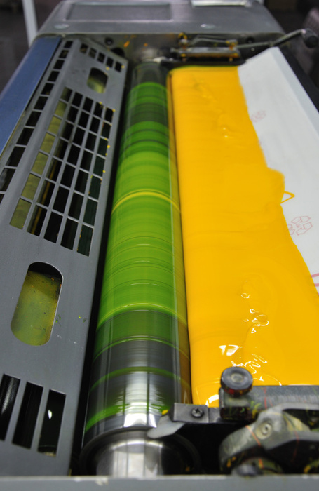

My printing units are KCMY. I always see green on it. May be come from ink trap. How to explain in depth? Thank you

Your ink is NOT being physically contaminated by any back-trapping. You are seeing an optical illusion. The ink in the fountain looks very yellow because it is very thick (mass-tone) and more opaque. The ink on the fountain ball roller looks green because it is much thinner and now more transparent, showing the dark black metal ball roller underneath it. Have you checked the hue error and grayness or hue angle (h') and chroma (C*) of the ink on the press sheet, which is what matters.

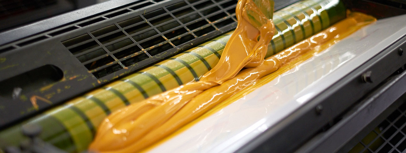

in the 2nd image, it looks to me that there is actually contamination from the cyan. The yellow ink is thick yet there are a few ripples of green, which appears to be contamination from cyan ink.
To be clear...I am not looking at the duct roller.
Are my eyes lying to me?
Could be a reflection.
I saw something very similar but way worse from a web press at a commercial printer in L.A. several years ago.
The yellow fountain was grossly contaminated and both magenta and cyan. It was mixed with yellow in places along the edges of the fountain where the ink was drier or coagulated. These areas were green and orange! So when I saw these pics, which show way, way less contamination (?), I immediately remembered the aforementioned.
Soooo, I'm skeptical of the masstone vs undertone explanation. OP may have a serious issue.
Look up Backtrapping on Google and you will get lots of ideas on how to deal with this. Yours does not look as bad as some I have seen and a little bit of press maintenance and good wash up procedures may help reduce it a bit, it is a part of 'wet trapping' and sometimes its as good as it gets.
Ink tacks can affect it but remember the tack number on the tin is just a number and does not take into account of fountain solution mixed in the ink. You can try running less water in the cyan(increasing tack) and more water in the yellow(decreasing tack) but dont go overboard

To the sceptics...... in the following two pictures of Yellow Ink Ducts, do you
see any "Contamination (Backtrapping)"
Regards, Alois
from what I can see in the pictures, maybe some in top image, but none in bottom two. But because I'm not there, and seeing it for myself, my confidence is maybe 50/50.

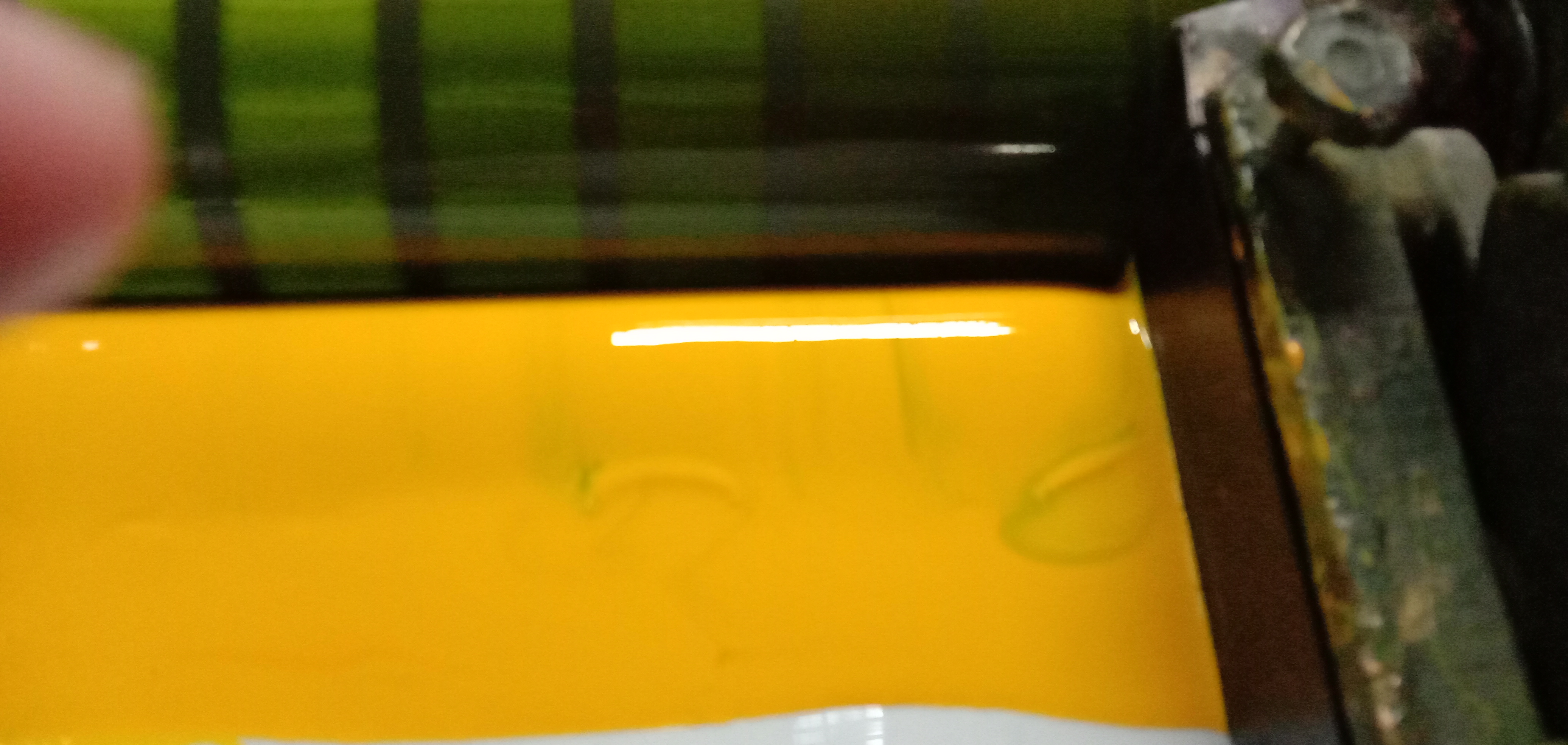

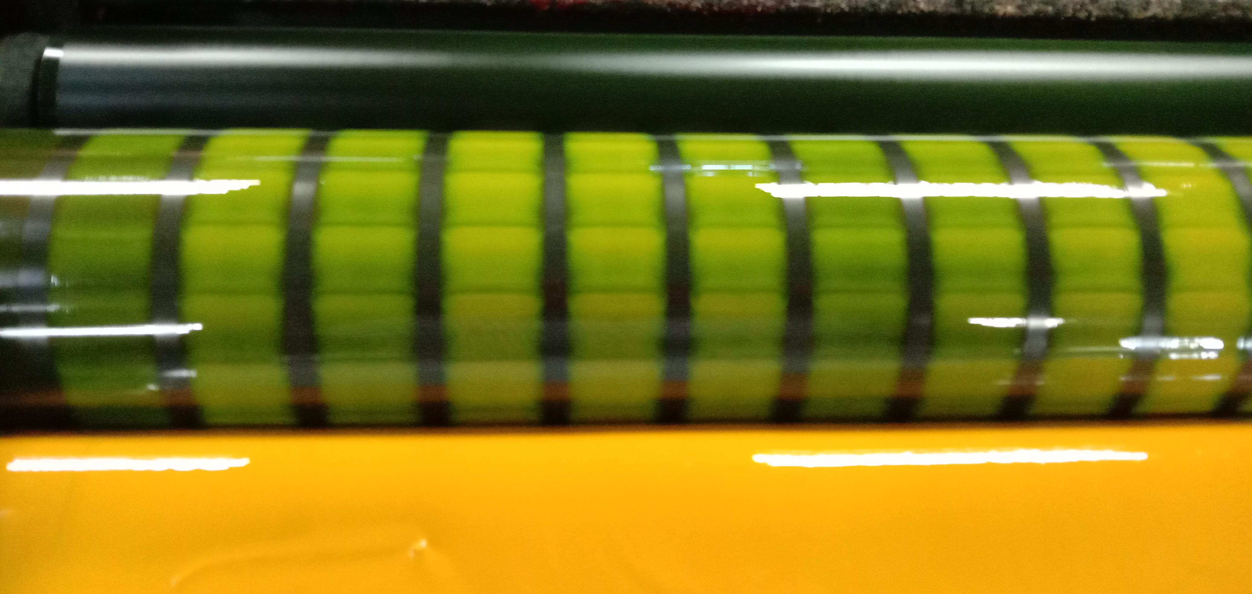

Gentlemen and all the Sceptics
I shall continue to posit.........Ink Contamination.
A telltale sign that this is taking place is, -- Trace "Whirls" (Magenta) appear of the backtrapping ink shows at where the bulk
of the Ink (Yellow) in this case, meets the Duct Interface. Printing Sequence -KCMY
Regards, Alois
Regards, Alois
Dear Alois
May middle and bottom pictures be ink shade ? Please explain for me if you think be backtrapping .Thank you

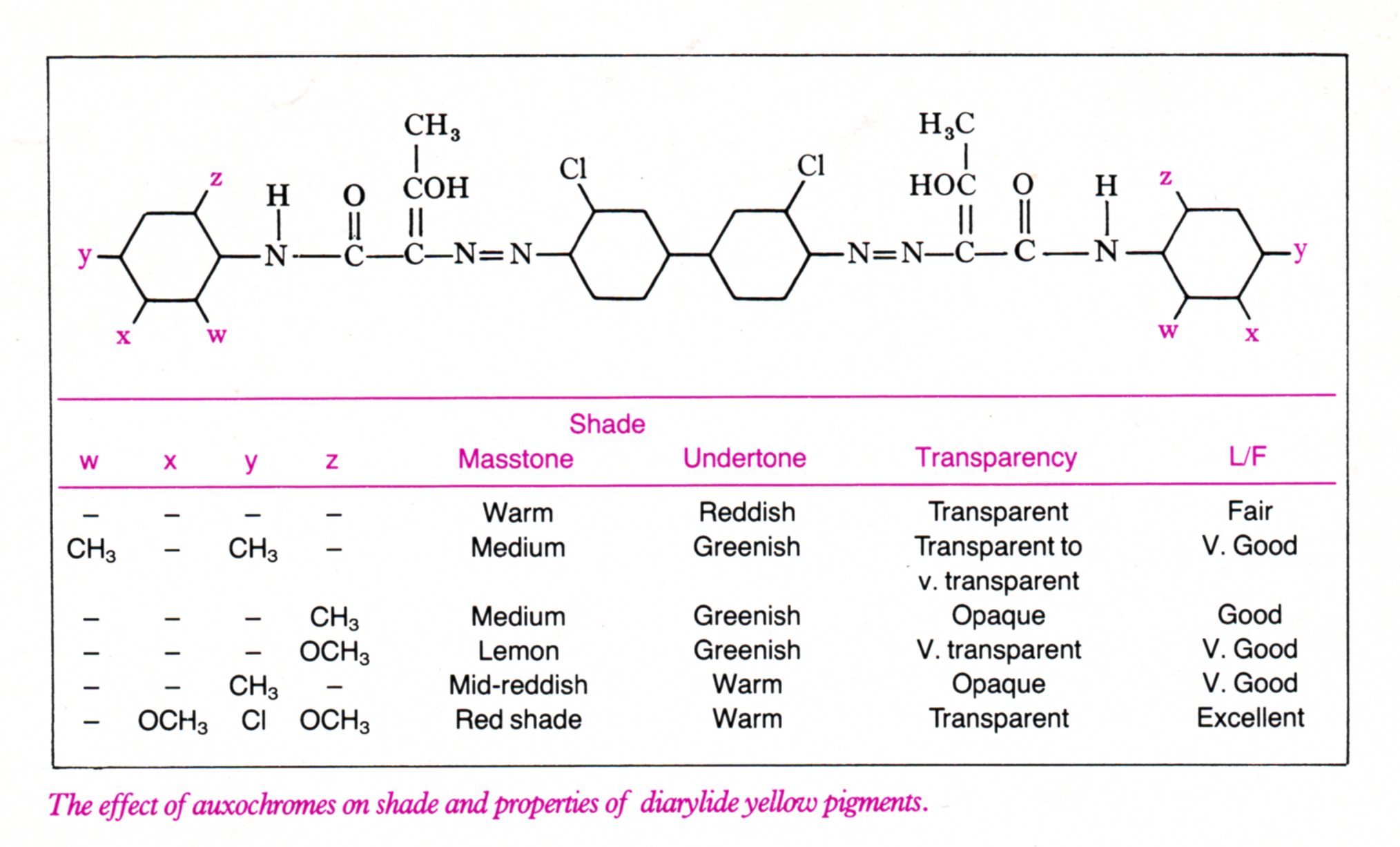

Hello sornchai,
Process Yellow Printing Inks are in the main produced from 1) Diarylide Pigments - Yellow 12)
2) Benzidine Pigments. Both have slight differences in "Masstone v Undertone "
